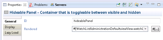

    Hi Guys,
    Thanks for your feed back.
    I tried to put a flag in the webservice call that give false if the table is empty and true when data is present.
    But still the table disappears after i click refresh.
    I tried using the rendered property both on hideable pnel and table the end result is the same.
    I also used the boolean data type for setting the rendered property but dint work.
    Is there a specific way to do it ?
    br,
    Kiran
    #webMethods
    #MWS-CAF-Task-Engine
    #webMethods-BPMS
  • 8.  RE: Hide table when empty
    Posted Wed May 04, 2016 05:11 AM
    Do not use both hideable panel and table rendered property at same time. Just stick to table Rendered property. Make sure your flag comes as boolean. If it is string then you can change your EL to something like below:
    #{sample.webservice.result.flag == “true”}
