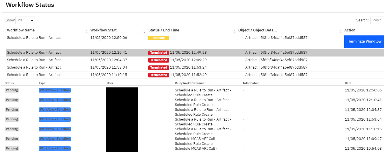

      |   view attached
    We have scheduler running on the AppHost and Postgres (not-containered). I can connect via PSQL remotely just fine to Postgres so it's not a connectivity issue from what I see.
    Unfortunately, the Download Logs gives me an error "Unable to complete the action due to an unexpected error. Access the logs using the following command on the App Host: sudo appHostPackageLogs". I ran the log collection from the CLI and attached but it really doesn't tell me much in the synchronizer or operator log.
    The app and workflow status will just stay running / pending and never do anything.

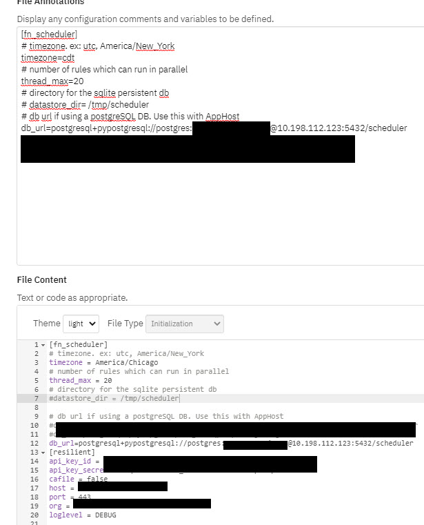

    Here is the app.config screenshots from the App Host config.
    I appreciate all the help!!!!
