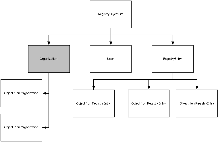

    Ans: the reason why i need to comeup with the create1.jsp pls refer to fig
    the rootnode is RegistryObjectList(ROL) but however i am not going to generate the pages for ROL but for its child Organization(Doctype).
    pls refer the two schemas rim.tsd and organizationdev1.tsd
    after generating the pages i will replace the rootnode from Organization to
    its relative parent ROL pls compare the create.jsp and create1.jsp
    (i.e) replacing the xpath for each and every element in Organization doctype to ROL doctype “/Organization/@accessControlPolicy” to “/RegistryObjectList/Organization/@accessControlPolicy
    i would like to know is it feasible to in this way

    the reason for the error of the generated application is the number of jsp tags within the page. Unfortunately, Tomcat creates a single big method containing all the code to create the page. If this method contains to many lines of code, the Java “jumps” are invalid.
    I tried out your example and had the same effect. The generator produces a structure.xml file. You can use a text editor and remove sub-elements from the tag of this file. I did this and created a new create.jsp with the regenerate option of the generator. This page could be compiled by Tomcat.
    Nevertheless, I got another error. It seams to be a BUG for loops whose selected node is an optional node.
    For example, the node ‘Name’ within the ‘Organization’ contains a loop for ‘LocalizedString’, but the ‘Name’ node is optional and there is no check if the node exists.
    The general idea to generate the pages for the ‘Organization’ node and to modify them for ‘ROL’ should be ok.
    You should provide an assurance that the ROL contains a ‘Organization’ node. For this, you could use if tag whithin a loop.
    I will send a new post when I find out a workaround for your problem.

    I send you two pages and the structure files that I used to generate them. The first one ?create.jsp? is the page that creates a document of doctype RegistryListObject. The page was generated from structure_rim.xml. Within this file, I disabled fields and modified some names within the tag to make them better readable, e.g. the list to iterate the ROL Entries.
    The page ?create.jsp? contains the functionality to add new nodes into the ROL Entry list. RegistryListObject is defined as a list of alternatives. By default the type of a new node is the first alternative. It is possible to switch the type of this node. If it?s an Organization, you can edit the values of the attributes of the Organization. At this place, I added a link referring to a sub-page ?editOrganization.jsp?.
            <xapp:elementaction type="select" base="ROL-Entries" form="form1">
    <a href="javascript:document.forms['form1'].action='editOrganization.jsp';document.forms['form1'].submit();">edit the organization entry</a>
    </xapp:elementaction>
    The sub-page allows you to modify the Organization node. It was originally generated from structure_org.xml. The changes I made within the structure file:
    (1) I corrected the paths for nodes
    (2) I added missing loops
    The resulting JSP ?create.jsp? was copied to the ROL application with the new name ?editOrganization.jsp?.
    Within the generated page I made the following adaptation for it works as a sub-page
    (1) I added a base attribute to the enclosing xapp:form tag
    (2) I replaced absolute paths ?/Organization? b relative paths ?Organization?
    (3) I replaced the reference to ?create.jsp? by ?editOrganization.jsp?.
    (4) I replaced the commit action by a link action.
    The pages are attached via zip file. You can extract them and try out by invoking the create.jsp directly. I added a check for an existing document.
