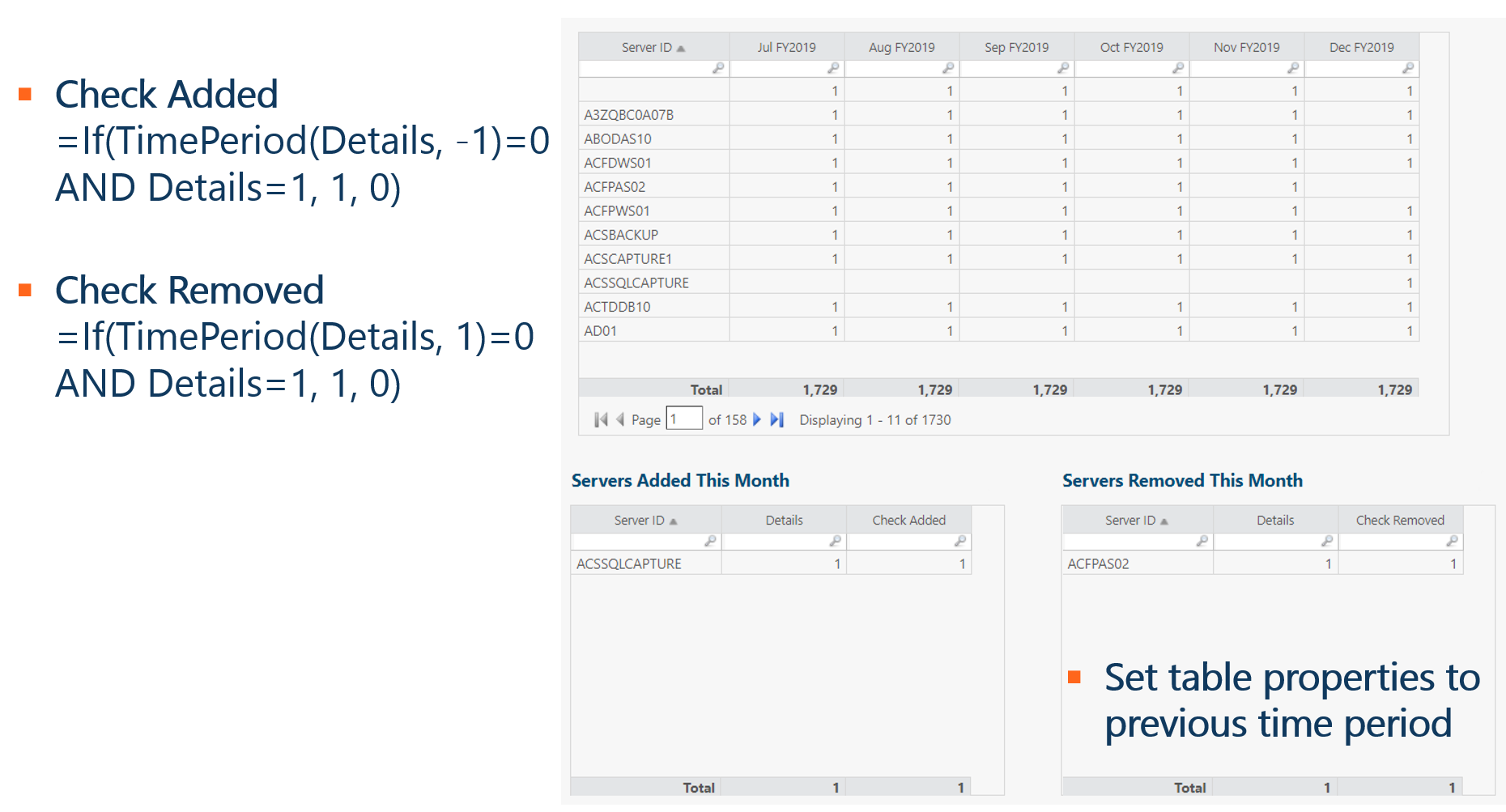

    Another option: Lock a report table to the previous time period (instead of the usual current time period), using Properties > Advanced > Time Lock.
    In this table, show Labor resources by employee ID and a simple count (such as "1" per row).
    Add logic which uses TimePeriod() to look forward 1 month (from previous month into current month) to check the count.
    Filter the table to show only rows where the detected future count is zero.
    The remaining rows show the employees who were present last month but are not present this month.
    The opposite strategy can show opposite results (employees new this month).
    Below is a similar example using server data instead of labor data.
