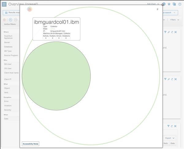

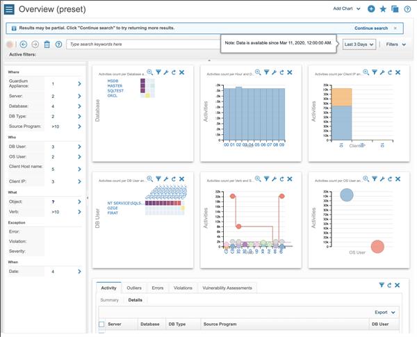

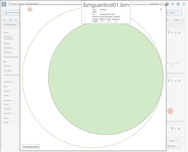

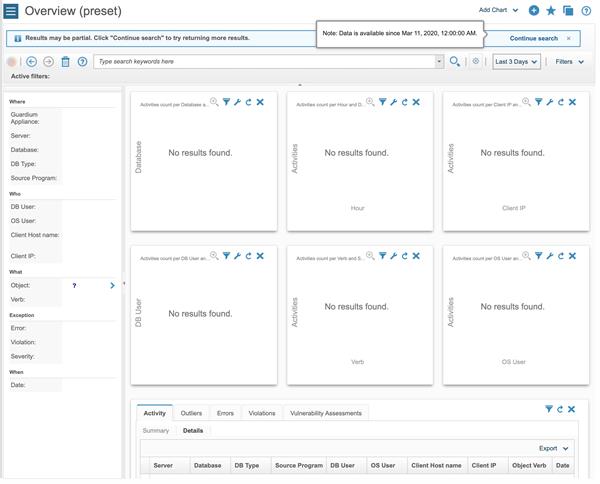

    We have enabled quick search on CM and COL, however quick search dashboard only works on COL. Data is coming. But there is no data on CM. What is the reason of this? Can you help me?

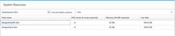

    System Config;
    Quick Search from CM;
    Quick Search from COL;

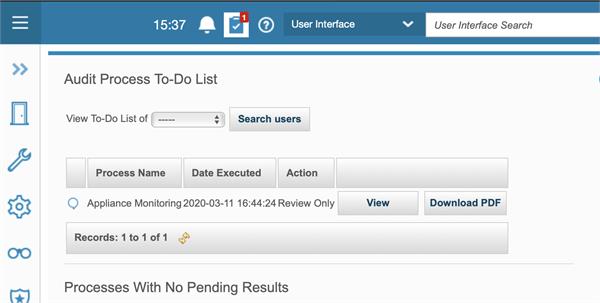

    I also have another problem with CM. I create the audit process report with daily frequency. But my first report is not deleted, I checked and examined it, but still nothing has changed. New reports come every day, they are deleted, but the first report was never deleted.

    I assume that your system is test one, because there is no need to setup CM with one collector.
    Here my suggestions:
    1 - network issues - check connectivity used by quick search, ports 8983, 9983
    2 - solr issues - execute these commands from cli:
    • grdapi restart_solr - collector and CM
    • grdapi refresh_quick_search_groups - collector only
    3 - resource issues - setup minimum 32 GB RAM and 8 cores for your appliances

    Regarding your Audit Process issue, do you mean the item is not deleted from TODO list?
    Could you please explain what exactly did you do?
    Did you modified the predefined Appliance Monitoring Audit process?

    The CM and the collector communicate using the full name resolution request and not the IP address. If your DNS server does not already contain this information, I suggest you add the following two commands on each appliance :
    support store hosts <IP_CM> <fully_qualified_domain_name_CM>
    support store hosts <IP_coll> <fully_qualified_domain_name_coll>
    Attention : the two lines on the collector and the CM
    Sincerely
    Mohamed AFEILAL
  • 11.  RE: Guardium CM - Search Dashboard Not Working
    Posted Mon March 23, 2020 06:49 AM
    Many thanks to everyone who responded.
    I solved the problem exactly with the Mohamed AFEILAL commands. Yes, the problem was from DNS. I entered an unreal Domain because this is a test system. It is working now.

    You need the minimum capacity required: 24 GB RAM and 4 core

    regarding your Audit Process issue, do you mean the item is not deleted from TODO list?
