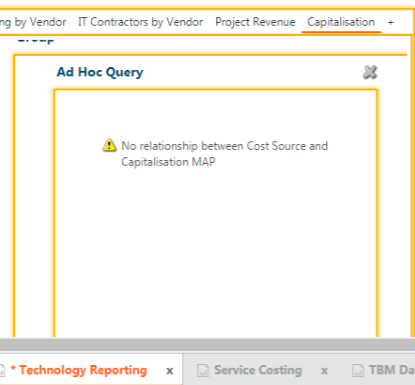

    I'm creating one report with a few graphs and tables and I'm getting an error in this one.
    Is there any way to block this graph? I mean, to be indeppendent and not be affected by the rest of the filters/slicers.
    (I tryed to created a group but doens't work)
    Any ideas?
    Thank you

    Have you tried putting the graph in a Tab? I typically put my slicers/filters in a tab with the graphs I want them to affect and leave the other graphs outside of the tab.

    No, doest work, still impact the Graph :/

    Make sure the the filters and slicers are inside of the group/tab that you want them to influence. You can over over the group or tab to see the outline of the item. When you are dragging the filter/slicer within the tab make sure the the blue dotted outline is within the yellow outline. If you are moving the filter/slicer too far over the edge the blue line will snap to the inside of the group/tab before the item gets placed outside of the group/tab.
    I like to make sure that I have a ton of space to work with so I usually make my groups or tabs as big as I can without having to scroll.
    Let me know if this helps. If not, could you provide a screenshot that includes where the slicer is?
