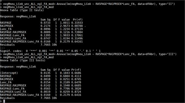

    When running a univariate GLM with several interaction terms, I am getting the same values when using Type-2 and Type-3 sum of squares (see attached image). If I run the same analysis in R, the Type-3 sum of squares looks the same as the SPSS output, but the Type-2 sum of squares is different.  Since the model has interaction terms, I would expect Type-2 SS to be different than Type-3. This makes me suspect that SPSS isn't implementing Type-2 SS correctly, is this possible?

    Appendix H in the Algorithms document spells out the Type II and Type III calculations (and Type I and Type IV).  Note that under some circumstances, Type II and Type III sums of squares will be the same.

    To expand on Jon's (correct) suggestion to check the algorithms, the four types of sums of squares (SS) used in the SPSS Statistics GLM and UNIANOVA procedures are based on the definitions given by SAS. Type I SS are dependent upon the order in which terms are entered into the model, and for models with terms specified in appropriate order, are equivalent to what are sometimes called sequential SS, as they can be calculated by comparing the residual or error SS from sequentially more complex models as individual terms are added. These are the SS given in the R anova class in the stats package.

    The Anova class in R's car package uses the terms Type II and Type III (or 2 and 3), but the definitions are not identical to the way SAS has defined them. From the first paragraph of the Details section of https://rdrr.io/cran/car/man/Anova.html: "The designations "type-II" and "type-III" are borrowed from SAS, but the definitions used here do not correspond precisely to those employed by SAS. Type-II tests are calculated according to the principle of marginality, testing each term after all others, except ignoring the term's higher-order relatives; so-called type-III tests violate marginality, testing each term in the model after all of the others. This definition of Type-II tests corresponds to the tests produced by SAS for analysis-of-variance models, where all of the predictors are factors, but not more generally (i.e., when there are quantitative predictors)."
    Since your specified model doesn't involve any factors, there are no containment relationships in the model. In these circumstances, Type II and Type III sums of squares as defined by SAS and in SPSS Statistics are the same. If you were looking at a model with all categorical predictors (what SPSS Statistics usually calls factors), then the Type II sums of squares should match those you get with R's Anova class from the car package. You should also get matching results regardless of the types of predictors if the model doesn't involve any product or interaction variables (in which case Type II and Type III SS would be the same in R as well).
    The difference in the two approaches is that the SAS approach relies on containment to determine which effects in the model are to be adjusted for when calculating sums of squares for a particular effect, while R relies on the marginality principle mentioned in the quote from the R car documentation. Containment is defined above, and is essentially arithmetic in nature, while marginality is based more thoroughly on theoretical principles.

    As noted, containment is a mathematical relationship, while marginality is more theoretical. The marginality principle says that it doesn't make sense to estimate or test effects that are marginal to higher-order terms of which they are a part, or to remove the marginal effects from the model as long as the effects to which they're marginal remain in the model. So if you have A*B (A:B in R) in a model, then testing A or B is not meaningful or appropriate, because the interaction implies that there isn't a single main effect of A or B, only effects fixing at levels of the other effect. This applies both to factors, where marginality leads to containment, but also to covariates, where it typically does not. That is, if you have covariates X and Z as predictors, and you also have their product or interaction term, then interpreting "main effect" slopes makes no sense, since the model implies that the slopes depend on the location on the other predictor, as is the case with factors, even if it doesn't lead to the same containment relations as with factors.
    So in SAS and SPSS Statistics, using the SAS definitions, if you have covariates and their interactions, since there are no containment relationships involved, Type II and III SS are the same, computable by comparing the change in residual SS from removing one term at a time from the overall model. The Type II SS in Anova in R, which bases things on the marginality principle, calculates SS for the highest order terms (those not marginal to others in the model) the same way, but lower order marginal terms are calculated by comparing changes in residual SS from removing that term from a model that contains only the other terms in the overall model to which that term is not marginal. So in a case like yours, with just three covariates and all their product terms, each main effect SS is calculated by adding a covariate to a model containing only the other two main effects and their interaction, or equivalently, removing it from a model with the other two main effects and their interaction, because these other two main effects and their interaction are the only terms in the full model to which this main effect is not marginal. For the two-way interaction terms, which are marginal only to the three-way term, each can be removed from the complete (one and) two-way model, or added to the model containing all other main effects and two-way terms. The three-way term is calculated by comparing the complete model to the model with all two-way terms.
    If you want the exact same test results in SPSS Statistics as are shown in the R Anova Type II table, it's possible to get them, but not with a single invocation of a procedure, and thus not in a single table. Running models with subsets of the terms in your full model with the default Type III SS will give matching effect SS for appropriate terms, but will also change the error term and df, so a syntax-only option based on use of the TEST subcommand would be needed.
    I'm going to use x1, x2, and x3 as covariates predicting the dependent variable y in the following example commands. You can adapt these to your particular variable names by substituting those names everywhere those generic names appear. Also not on the TEST subcommands that I'm specifying SSE and DFE, which you would replace by the appropriate numbers (7.7665 and 106, respectively, for this example).
