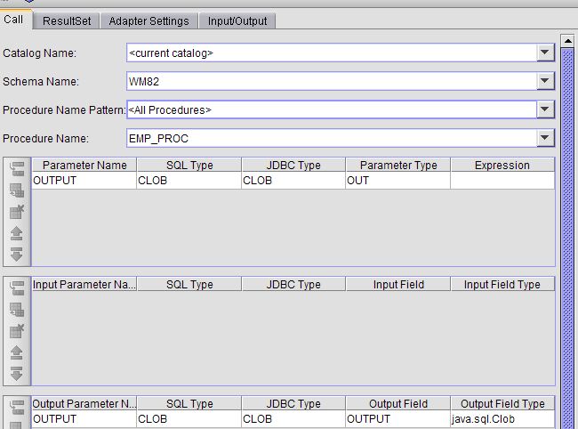

    Created a storedProcedure which returns xml output as CLOB Object and able to successfully compiled. When running the adapter service getting below error msg:
    [ADA.1.316] Cannot execute the SQL statement “{call WM82.EMP_PROC( ?)}”. "
    (42000/932) ORA-00932: inconsistent datatypes: expected - got -
    ORA-06512: at “WM82.EMP_PROC”, line 7
    ORA-06512: at line 1
    Did anyone get a chance to call storedProcedurewithSignature which is having output of type CLOB … Kindly through some light to resolve.

  • 2.  RE: Getting error when executing storedProcedurewithSignature Adapter service.
    Posted Mon March 30, 2015 08:12 AM
    Please change the Java-Outputtype to java.lang.String to avoid any casting issue upon usage of the service.
    Can you check the signature of the StoredProcedure to check the datatypes?
    Additionally please provide your wM-Version with applied Fixes.
    Maybe some Fixes are outdated and when you apply newer Fixes the issue might get resolved by this.

  • 3.  RE: Getting error when executing storedProcedurewithSignature Adapter service.
    Posted Mon March 30, 2015 12:35 PM
    Yes you should try change the output field type to java.lang.String and test it.
    Follow the rest of the points/checks as Holger suggests if the above change doesn’t works.

  • 4.  RE: Getting error when executing storedProcedurewithSignature Adapter service.
    Posted Mon March 30, 2015 05:05 PM
    Thanks Holger & RMG for your help.
    Signature of StoredProc is :
    create or replace procedure emp_proc(OUTPUT OUT CLOB)
    AS …
    I successfully compiled it without any errors in Oracle DB.
    I tried to change the data Type as you suggested but still getting the below error:
    I am trying this in my local and details are as below:
    version: 8.0.1.0/
    Updates:IS_8-0_SP1
    Please suggest to resolve this.
    Thanks for your help.

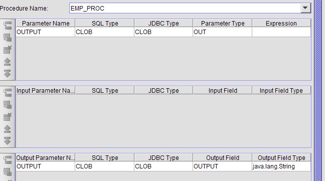

    Even though the CLOB type why don’t output field type of java.lang.string doesn’t work for you as it supposed to work?
    HTH,
    R<G

  • 9.  RE: Getting error when executing storedProcedurewithSignature Adapter service.
    Posted Tue March 31, 2015 03:31 PM
    RMG, as you specified in earlier threads, I changed output field Type to java.lang.String but still I am getting the earlier which I said earlier.

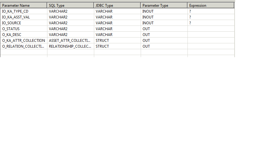

    I have a similar problem. The output which i’m getting from DB is of collection type. When I have used StoredProcedureWithSignature, collection variable is reflecting as STRUCT type variable. But when I execute the adapter service getting the below error:
    Could not run ‘sample’ com.wm.pkg.art.error.DetailedServiceException: [ART.117.4002] Adapter Runtime (Adapter Service): Unable to invoke adapter service provider.adapter:sample.
    [ADA.1.316] Cannot execute the SQL statement “call GETASSETDETAIL( ?, ?, ?, ?, ?, ?, ?)”. "
    (65000/6550) ORA-06550: line 1, column 7:
    PLS-00306: wrong number or types of arguments in call to ‘GETASSETDETAIL’
    PL/SQL: Statement ignored
    Attached is input output structure from webMethods.
    DB SP signature defined as:
    PROCEDURE getAssetDetail (
    io_KA_TYPE_CD IN OUT VARCHAR2,
    io_KA_ASST_VAL IN OUT VARCHAR2,
    io_SOURCE IN OUT VARCHAR2,
    o_STATUS OUT VARCHAR2,
    o_KA_DESC OUT VARCHAR2,
    o_KA_ATTR_COLLECTION OUT ASSET_ATTR_COLLECTION,
    o_RELATION_COLLECTION OUT RELATIONSHIP_COLLECTION);
    Where ASSET_ATTR_COLLECTION defined as:
    create or replace TYPE ASSET_ATTR_COLLECTION AS TABLE OF ASSET_ATTR;
    And ASSET_ATTR is defined as:
    create or replace TYPE ASSET_ATTR AS OBJECT (ATTR_NAME VARCHAR2(50), ATTR_VAL_TXT VARCHAR (4000))
    Request you to guide us what are the steps we need to do while creating the adapters to handle such output types from DB.
