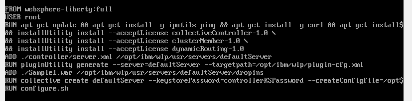

    It seems that reply for this question is not displaying properly, there is no name of the feature to be enabled. I believe it is localConnector-1.0, however I do have this feature installed and enabled and I am still experiencing this error when I try to build websphere container (doesnt matter the edition, tried latest, full and web-profile 8) using Dockerfile.
    Oddly enough, when container is started and I try to run pluginUtility generate --server=defaultServer --targetpath=/opt/ibm/wlp/plugin-cfg.xml it works just fine. Is there any particular step/place where I need to run pluginUtility to work properly? I am sure I've managed to get it running few months ago when I was playing with Websphere Liberty image for Docker, but it does not work for me anymore. Here is my full dockerfile:
    Would be grateful for any hints.
    Cheers, Chris

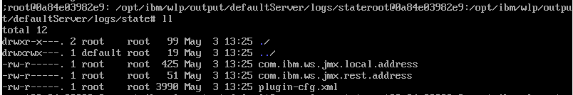

    I think I've found cause of a problem in my installation. It appears that path which is thrown in error message is different than actual path where jmx.address file resides:
    File can be found at /opt/ibm/wlp/output/defaultServer/logs, while Liberty is searching for the file in ../defaultServer/workarea which does not exist.
    Do you have any idea how this can be fixed?
    Thanks in advance,
    Chris
