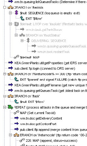

  • 12.  RE: FTP problem in WebMethods
    Posted 06/13/06 07:23 AM
    Hi Rob,
    Please find screen shot of the code as attached below.After log in to ftp server the return code is checked if it’s >=300 then the service performs an exit from try block and the error is catched in catch block.
    Mark thanks for your suggestion we have asked for ftp logs from the partner.

  • 13.  RE: FTP problem in WebMethods
    Posted 06/13/06 05:04 PM
    Yogesh: Checking for returncode >= 300 should do the trick, as you have in your service. But you might consider checking if sessionkey is $null instead. If sessionkey != null, then you have an FTP session. If it is $null, then the login in failed (regardless of what the returncode might indicate).
    If you review VAN.VANConnectivity:putToVAN in the WmEDIforTN package you’ll see that wM-provided services don’t rely on FTP return codes.
    A couple of other observations:
    • Your service isn’t using a try/catch block. That means on error, your FTP session may be left open. The default behavior of IS is to reuse FTP connections, which can cause problems in subsequent calls.
    • After your getQueuedTask call, if the task is $null you’re exiting. You need to close the FTP session.
    HTH.

  • 14.  RE: FTP problem in WebMethods
    Posted 06/13/06 10:48 PM
    Hi Raemon,
    Thanks for your suggestions will also check for session key and will explicitly logout if tasks are null.
    The flow service is written in a try catch block but due to size restrictions could not attach the screen shot of the entire so had to crop it.
