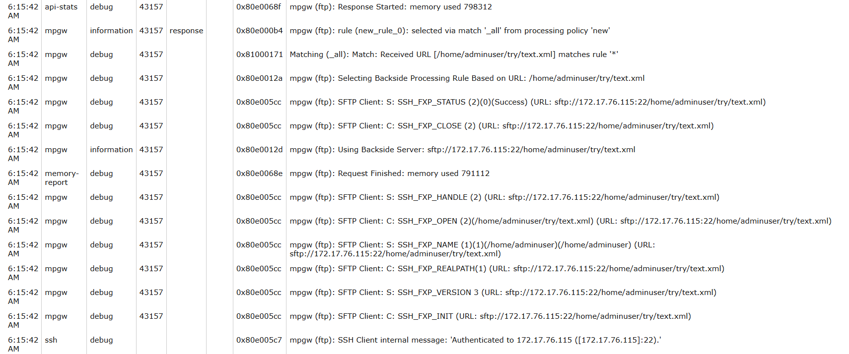

                 Created a sftp protocol to show demo where our environment are cipher enabled connection.
                 Here i have used static filename and for dynamic please apply a xslt with route-uri function.
    Sample sftp polling: successful case
    After successful connection sending to another location:
    remote folder:
    destination folder:
    SFTP screen:
