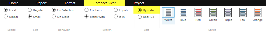

    We all know that report slicers in the same report influence other slicers when 'By state' has been set.

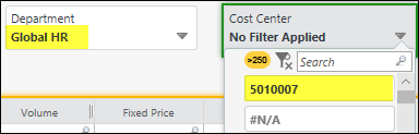

    In the situation that you select a value in the first slicer that generates actually one value in the second slicer only (one on one relation), the value in the second slicer will be bold reported at the top of the list. See the following screenshot as an example where Global HR is selected in the first slicer and Cost Center 5010007 is bold reported at the top of the list in the second slicer.
    For a one on one relation between two slicers and values we prefer that the value in the second slicer (in this case Cost Center 5010007) is directly shown in the Compact Slicer Cost Center like the following screenshot.
    Does anybody know a solution for this?

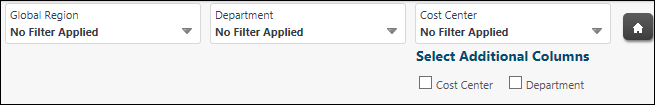

    For now and as a work around, we added a Column Picker to add additional columns to the report to show the Department and Cost Center values immediately in the report when required.
