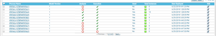

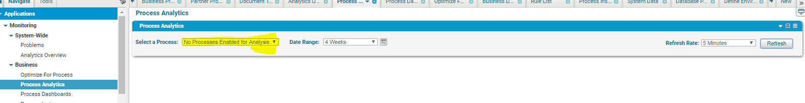

  • 6.  RE: Failed to evaluate binding expression: "#{StagesStagesView.stageListUTableProvider}"
    Posted Thu July 05, 2018 08:36 AM
    Hi Shrikant,
    I have deployed the process using the depoyer and trying to enable the process from MWS UI for analysis.While enabling it shows error but in the business process it shows enabled.
    PFA screen shot for the same.
    Regards,
    Vijayakanth V
    #webMethods-BPMS
    #webMethods
    #MWS-CAF-Task-Engine
  • 7.  RE: Failed to evaluate binding expression: "#{StagesStagesView.stageListUTableProvider}"
    Posted Thu July 05, 2018 08:50 AM
    Hi Vijayakanth ,
    So it means even if you see the error thrown when you enabled process for analysis from MWS UI , its working ?
    Can you please check if you are able to see process analysis view for that BPM for which you enabled Process Analysis .
    Thanks
    Shrikant
