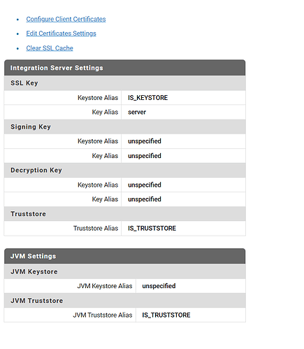

    Trying to upgrade from webMethods 10.05 to 10.15. Recently installed webMethods 10.15 and configured db connection. Everything seems successful. Integration server runs well without any errors and I’m able to login and play around with the UI. However, whenever I run MWS it crashes shortly after with the below error:
    Furthermore, I can go to security > JDBC pools on UI and test my connections and they all come back successful. On top of that the certificates have also been configured and they don’t expire until at least an year. Please let me know if you need any other files and I’ll be happy to provide them. If anyone has any idea on how to fix this, that’ll be very helpful. Thank you!!
    Error Line:
    (I have removed url and serviceName for privacy purposes)
    *Error creating database connection to: jdbc:wm:oracle://[DBURL]:2484;serviceName=[NAME];EncryptionMethod=SSL;CryptoProtocolVersion=TLSv1.2;ValidateServerCertificate=true;HostNameInCertificate=[DBURL]*
    *java.sql.SQLNonTransientConnectionException: [SoftwareAG][Oracle JDBC Driver]SSL handshake for https://[DBURL]:2484/ failed: PKIX path building failed: sun.security.provider.certpath.SunCertPathBuilderException: unable to find valid certification path to requested target*
    Here’s the full sag-osgi.log file and picture confirming certs setup in UI:

  • 2.  RE: Failed: PKIX path building failed error MWS webMethods10.15
    Posted Thu February 01, 2024 08:33 AM
    Hi,
    can you share your mws.db.xml from the MWS/server/default/config directory, please?
    Additionally check the MWS/server/default/bin/server.properties.sh and the profiles/MWS_default/configuration/custom_wrapper.conf for correct settings of Keystore and Truststore.
    The configuration visible in IS does not relate to the MWS configuration.
    Regards,
    Holger

  • 3.  RE: Failed: PKIX path building failed error MWS webMethods10.15
    Posted Thu February 01, 2024 11:41 AM
    Thank you for your response! I checked the files you mentioned and I did have wrong certificates in there so I fixed it and tried to restart it.It fixed the previous error, however, it still doesn’t start with the below error:

  • 4.  RE: Failed: PKIX path building failed error MWS webMethods10.15
    Posted Thu February 01, 2024 03:01 PM
    One time Database configurator run completed successfully, before starting MWS?
    Is your IS and MWS run on same RHEL instance ?

  • 7.  RE: Failed: PKIX path building failed error MWS webMethods10.15
    Posted Mon April 29, 2024 05:08 AM
    Hi,
    do you have a JDBC Connection in IS JDBC Connection pools pointing to the MWS Database schema using the same SSL connection parameters?
    If yes, is this one working?
    Usually, the “PKIX path building failed” error indicates, that the certificate presented by the server cannot be verified to a valid CA chain defined in truststores and/or cacerts file of the JVM.
    BTW: Port 2484 is a very uncommon port for an Oracle Database.
    Regards,
    Holger
