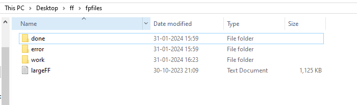

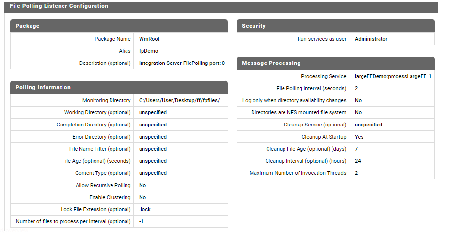

    I am trying to do filepolling in my local 10.15 server. I am able to create file polling port successfully and when i place the files in monitoring directory i dont see the files getting picked nor any logs related to filepolling getting written.
    All i see is this
    [ISS.0028.0048E] (tid=1004) Failed to read class com.wm.ff.net.FilePollFilter from input stream
    and not sure what needs to be looked for this.
    i thought its file permissions issue but when i go getFile from that location i am able to fetch from that location so its not file permission issue.
    Can you please help on this…

    The error is due to a missing/corrupt JAR that holds the com.wm.ff.net.FilePollFilter class, which is unusual. Were there any installation/migration errors?
    What is your Flat File module fix level?
    The latest is webMethods Flat File 10.7 Fix 13 and I see a filter-related issue resolved, but yours seems unrelated.
    Set a value for “File Name Filter” and share the result.

    I have installed the fixes from update manager for my trial version after installing the SAGUpdate bootstrapper and after that the issue got resolved and you are right
    Integration Server
    ** Flat File 10.7 Fix9 10.7.0.0009-0003**
    After this the issue got resolved
