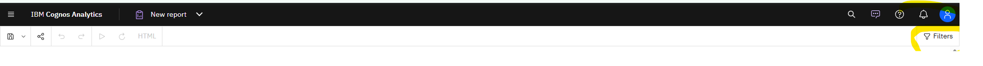

    Hi Team,
    Could you please help me how to hide below filter icon in the Viewer
    Thanks,
    Srini

  • 2.  RE: Extra Filter Icon in Cognos 12.0.4
    Posted Mon April 28, 2025 10:35 AM
    Hi,
    the first thing that comes to my mind is to deactivate the full intractivity. Go to Report-> Report and then to the properties pane:
    Keep in mind that this renders the report in a different view mode. Interactive visualizations (version 11.1)  are not supported anymore.

  • 3.  RE: Extra Filter Icon in Cognos 12.0.4
    Posted Mon April 28, 2025 11:26 AM
    Hi,
    Thanks for the suggestion, We need the full interactivity Yes and Filter icon need to disabled in Cognos Viewer

  • 6.  RE: Extra Filter Icon in Cognos 12.0.4
    Posted Tue April 29, 2025 07:03 AM
    Hi Marc Reed,
    Thanks for the response  , Enable on-demand Toolbar option disabled  in the Properties and still i am getting Filter icon in the viewer, Could you please let me know how to disable the Filter icon

  • 7.  RE: Extra Filter Icon in Cognos 12.0.4
    Posted Tue April 29, 2025 08:05 AM
    Hi Srini,
    then there is no way to hide the filters area in the report I'm aware of. The On-Demand Toolbar can be hidden in properties of roles, but that does not hide the filters pane as well:
    The only hint I have is to follow these instructions here and look if you can find the UI element and its ID.

  • 8.  RE: Extra Filter Icon in Cognos 12.0.4
    Posted Fri May 02, 2025 10:36 AM
    Hi Srini, Robert,
    In fact it is possible to hide the Show filters button using the Feature customization for a role.  For Interactive-viewer reports, menu options that can be hidden are found in the Reporting section.  In particular for this case, uncheck the Show filters option found under Reporting > Collections > Toolbar.
    Here is a link to the documentation about role-based Feature customization (to hide/show elements in the UI):  https://www.ibm.com/docs/en/cognos-analytics/12.0.x?topic=roles-examples-hiding-menu-options-feature
    (For users that belong to multiple roles, the profile with highest priority is applied.  You can increase the priority for the role on the Customization tab under Advanced).
    After the changes are applied, log out / log in as the user who is a member of the affected role.  Now the Show filters button will no longer appear in the Reporting toolbar.

  • 10.  RE: Extra Filter Icon in Cognos 12.0.4
    Posted Mon May 05, 2025 09:32 AM
    Hi Srini, Robert,
    In fact there is a way to remove the "Show filters" button from the toolbar for Interactive-viewer reports using the Feature customization for a role.
    Here is a link to the documentation:  https://www.ibm.com/docs/en/cognos-analytics/12.0.x?topic=roles-examples-hiding-menu-options-feature
    In the Features customization, you want to disable "Show filters" found under Reporting > Collections > Toolbar.
    After applying the change, users who belong to the role will no longer see the Filters button in the toolbar.
    (Note, for users who belong to multiple roles, the profile with the highest priority is applied.  You can increase the priority under the Advanced section of the role's Customization tab).

  • 12.  RE: Extra Filter Icon in Cognos 12.0.4
    Posted Wed April 30, 2025 02:23 AM
    This isn't a great solution, but you can try this.
    Place an HTML item on the page with this:
    <style>
    #AppToolbarRightPane_btnFilters{display:none}
    </style>
    The problem I have with it is that the filters button does appear for a moment while the report is rendering.
