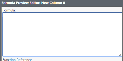

  • 4.  Re: Expand lookup returning various
    Posted 01/10/17 10:13 AM
    Are you viewing the formula using the preview editor?  If you are, it'll throw an error by default I believe.  Hit save and see what happens bc your formula looks ok.

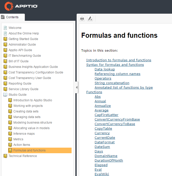

  • 6.  Re: Expand lookup returning various
    Posted 01/10/17 11:43 AM
    Hi Colin,
    There is indeed! If you go on any of your Apptio instances, then click the help link on the very bottom, it should take you to a page that looks like the image I attached. Then just follow the links I clicked to get to the Formulas and functions homepage bit. From there, you can see all the types of formulas possible in Apptio, along with examples of how to use each one
    Oli

  • 12.  Re: Expand lookup returning various
    Posted 01/10/17 04:41 PM
    Thanks Jenny
    As always you have come to the rescue. Yes I was using the preview screen and once the saved it the formula worked (partially). I am getting a result but it appears I only get the first server name in the list.
    Should return about 40 servers for PWS and 80 for SAP but I only get one, I can't see any switches that change the result but will continue to look myself and will update the thread if I find the result.
    Is this preview screen error a known bug? Would this also account for the issue I was having with a tablematch function last week and so many others I have abandoned over time?
    #TBMStudio
  • 13.  Re: Expand lookup returning various
    Posted 01/10/17 09:20 PM
    Happy to help   Yeah, I've seen someone mention that lookupex/preview window issue before and have run into it myself.  It is a known issue per this thread.
    Not sure, tho, if that affects tablematch, tho.  I'm not as familiar w/the tablematch function, but there's a ton of good stuff out there in this forum.  Very good thread on troubleshooting.
    Very weird your LookupEx isn't returning all matches bc your formula looks correct.
    In looking at the Servers Master Data, you do have multiple server IDs per BU consumer?
    The only other thing I could think of is if you have some sort of grouping going on - do you have a 'group by' on App Family perhaps?
    Do you have more than one LookupEx in the transform?
