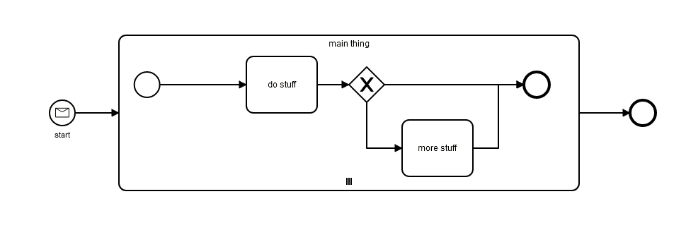

    From your description, you have a single business process which processes incoming messages sequentially.
    Something like this example (see the little marker on the bottom center of the “main thing” task):
    Is it feasible to change your design?
    Otherwise, you’d have to manage messages outside of your process (which removes transparency from your design) or use synchronizing signals in to the process (which adds unneeded complexity).

    Did you produce the process model with the Designer? It’s a nice image!

    I used bpmn.io which has a simpler interface but I could just as easily use Designer.
    But I didn’t have a Designer installation on this machine and bpmn.io runs through the web.
    maybe one day SAG decides to go to full web-based development so no installation is required (like Dell Boomi or Camunda)
