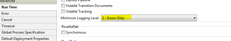

    Hi Raj,
    thanks for ur help, I tried bringing down the logging level to 2 but am getting the following error :
    [MID=] Logging level for Model cannot be set below minimum value of 5.
    Looks like its not allowing the logging level to be decreased.
    I even tried by disabling the resubmit options of steps and transition logging but its of no help.
    thanks,
