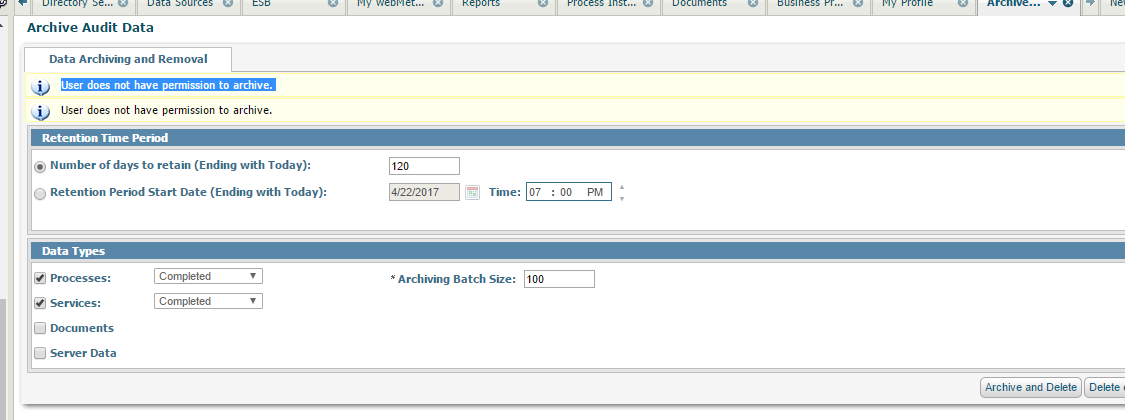

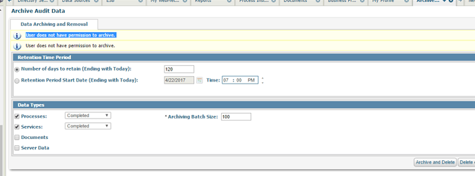

    Hi All,
    While trying to archive old audit data in MWS. It is saying User does not have permission to archive. Any one can please suggest what action to be performed to achieve this.

  • 2.  RE: Error while archiving Audit data
    Posted 05/22/17 03:06 PM
    Hi Sunil,
    make sure that all prerequisites for archiving have been setup correctly.
    Refer to Monitor Users Guide for further informations.
    This affectes settings in WmMonitor package, IS JDBC-Pools settings, SAML Resolver URL in IntegrationServer as well as grants and certain configurations in the database schemas for auditing and archiving.
    Which user are you trying to use for starting the archiving via MWS?
    Administrator or other user?
    Are there several IntegrationServer defined in MWS or not?
    If there is only one IntegrationServer defined, this should be working if all other things are setup correclty.
    If there are several IntegrationServers are defined, then this will not work as the Archiving pportlet does noit include the IS server selector portlet (at least up to 9.5 SP1; I am not sure for newer versions).
    Which version of wM are using?

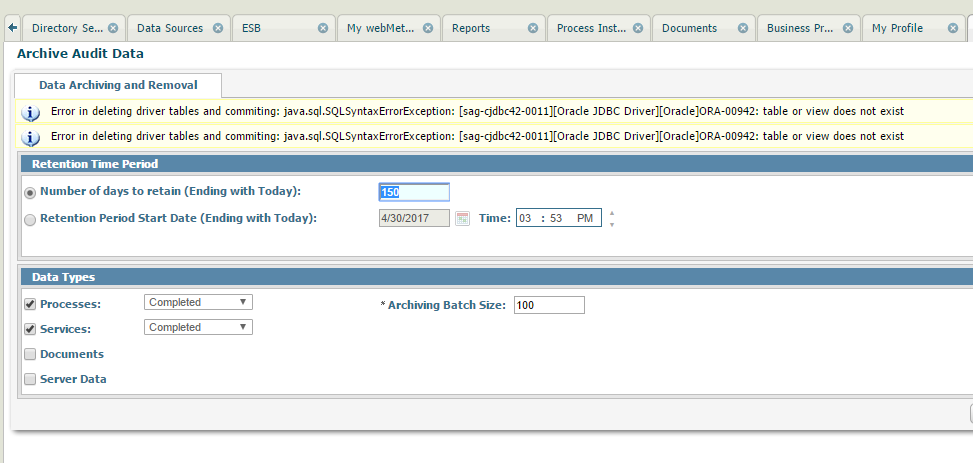

    I have set the prerequisites for this archival process and now I am getting the different error like:
    Error in deleting driver tables and commiting: java.sql.SQLSyntaxErrorException: [sag-cjdbc42-0011][Oracle JDBC Driver][Oracle]ORA-00942: table or view does not exist
    Even though the tables are existing in the DB.
    Can you please suggest what is going wrong in this and what all other things we can perform.
    Regards,
    Sunil

  • 6.  RE: Error while archiving Audit data
    Posted 05/30/17 09:22 AM
    Hi Sunil,
    looks like you have an issue with the JDBC-Pools for ISCoreAudit and Archiving.
    Did you setup archiving schema with proper grants for ISCoreAuditSchema?
    Did you update OPERATION_PARAMETER table in Archive schema with the name of the ISCoreAudit schema?
    Regards,
    Holger

  • 7.  RE: Error while archiving Audit data
    Posted 05/31/17 10:32 AM
    Hi Holger,
    I have taken the server log and in the log it is saying WMSERVICE_DRIVER table is not existing. I checked for this table in the DB, But no where this table available.

    2017-05-30 15:17:07 BST [MON.0119.0305E] Error in deleting driver tables and commiting: java.sql.SQLSyntaxErrorException: [sag-cjdbc42-0011][Oracle JDBC Driver][Oracle]ORA-00942: table or view does not exist

  • 8.  RE: Error while archiving Audit data
    Posted 05/31/17 01:01 PM
    Hi Sunil,
    can you please provide screenshots for the following:
    • Overview of the JDBC Pools page from IS Admin UI
    • Details for the JDBC Pools for IS Audit and Archiving function
    • List of tables present in the db schema used for the Archiving function
    • Content of the OPERATION_PARAMETER table in the db schema used for the Archiving function
    In DB-Configurator there is a component named Archving. This one needs to be executed against the schema for the Archiving function.
    This component should create all neccessary tables, packages etc. needed for archiving.
    The WMSERVICE_DRIVER table as well as the other DRIVER tables are intermediata tables in which the context ids for the objects selected for archiving/deletion are recorded before starting the real archiving/dleletion process.
