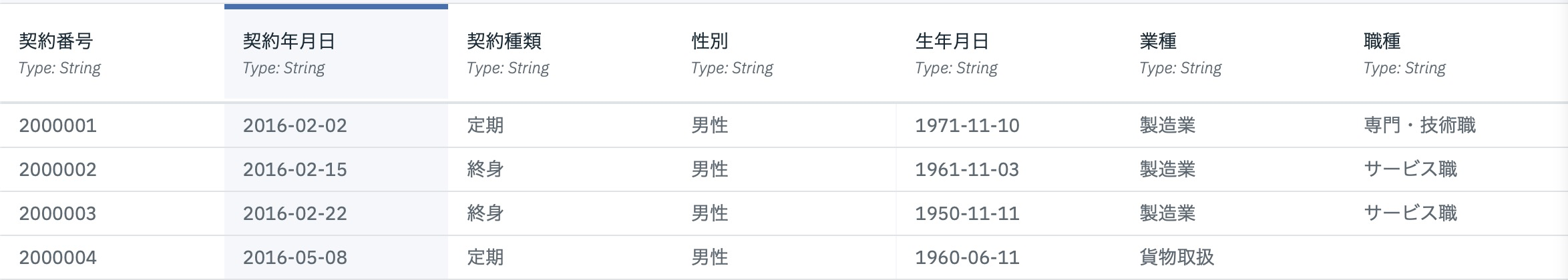

    Hello, I tried to export data containing YYYY-MM-DD fields like following to a data asset in Modeler flow.
    Test data used when I got the error message
    But I got the error message below.
    Error
    WDP Connector Error: com.ibm.connect.api.SCAPIException: CDICO9999E: Internal error occurred: Illegal argument error: Unexpected date object type (java.util.Date) (error code: DATA_IO_ERROR)

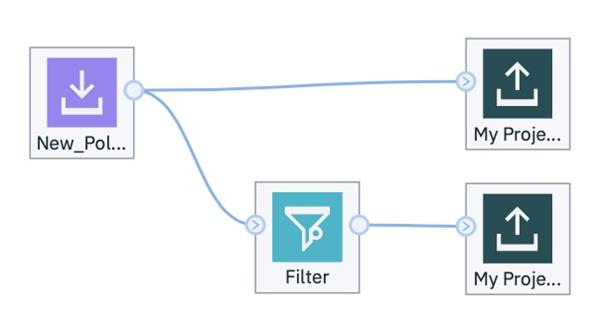

    It seems that this relate to Date fields, so I omitted two YYYY-MM-DD fields from original data with Filter node. Then I could successfully export data. (I created simple flow to test this issue. The upper flow in the following image failed with the error and the lower flow cloud successfully run without error.)
    How should I do to export YYYY-MM-DD format data?
