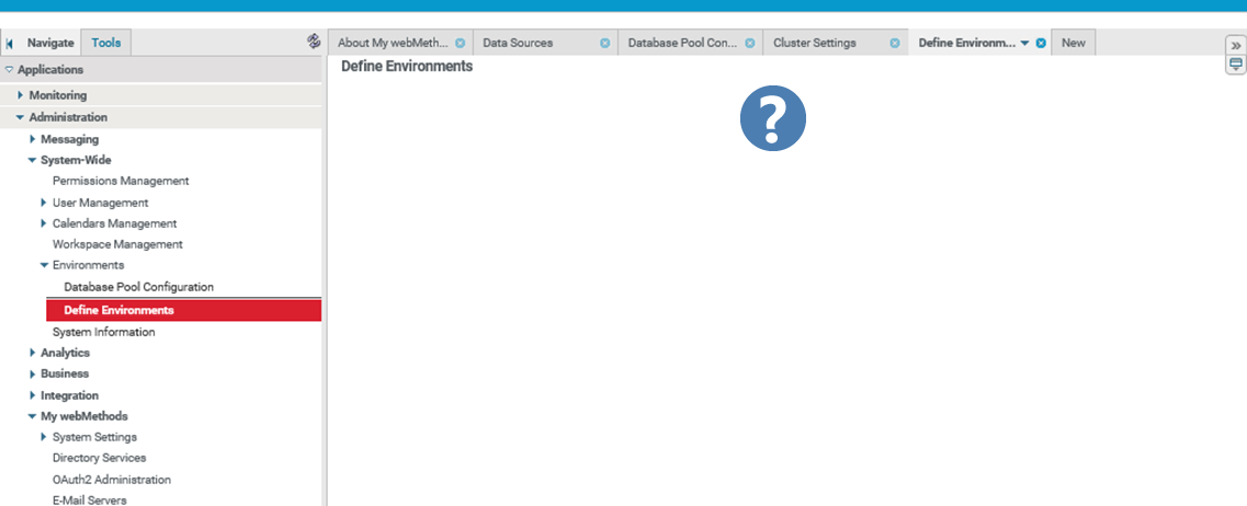

    Hi Expert,
    I am in a migration from 9.7 to 10.1, for some reason I stop working the option Define Environment, I have reinstalled the porlet but still not corrected .
    Someone open this kind of error and tell me how to correct them, please.
    Kind regard
    Angel

    Hi Angel,
    is there anything in the MWS full.log related to the time when you try to access the portlet?
    Is the Database schema for MWS defined correctly by the Database Configurator?
    Might be that it is missing “Central Configuration” part.
    Regards,
    Holger
