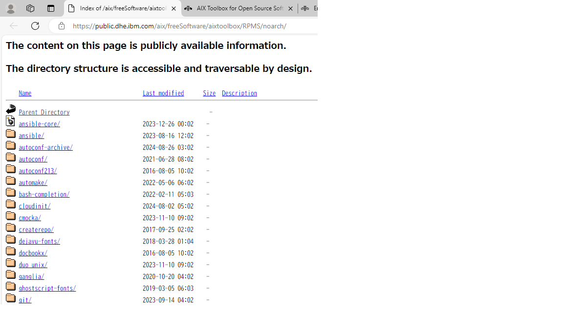

    I heard as correct URL as following. And we able to connect to URL. I will try download for each RPM file by wget command . And I use it for build to local Repo.
    https://public.dhe.ibm.com/aix/freeSoftware/aixtoolbox/RPMS/noarch/
    https://public.dhe.ibm.com/aix/freeSoftware/aixtoolbox/RPMS/ppc/
    https://public.dhe.ibm.com/aix/freeSoftware/aixtoolbox/RPMS/ppc-7.3/

    Thank you for your response. Please check out the one previous thread I posted. I can connect to these URLs from my PC and see the internal structure. Attach a screen capture. From each URL site, I downloaded a chunk of rpm files with the wget command. We will try to build a local repository in our AIX environment.
    Thank you

    I got chank of rpm file from AIX toolbox site by wget command. But I not able to find file as dnf_aixtoolbox_local.sh. It seem that diffrent from dnf_aixtoolbox.sh on IBM Toolbox web site.  How we can get file as dnf_aixtoolbox_local.sh.
    ・IBM Toolbox web site
