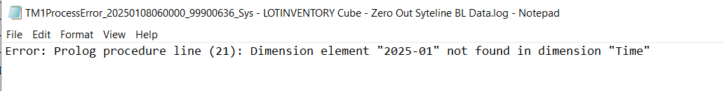

    Hello,
    I need help understanding how to address the following error: (see image also)
    Error: Prolog procedure line (21): Dimension element "2025-01" not found in dimension "Time"
    error log

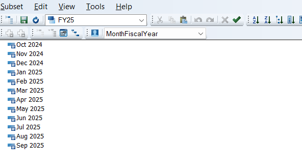

    I think it is triggered because my time dimension format is MonthFiscalYear  (see image also)
    time dimension

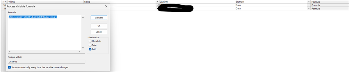

    but the current Process Variable Formula is as follows:
    vTime=subst(Today(1),1,5)|subst(Today(1),6,2);
    so it produces 2025-01.  (see image also)
    variable
    To fix this, do I change the formula to produce something compatible to my time dimension so TM1 recognizes it? If so, I have edited the variable formula as follows...vTime=subst(Today(1),6,2)|'-'|subst(Today(1),1,4); to return 01-2025

    In short, open the }ElementAttributes_Time cube (you may need to select View > Display Control Objects in Architect to see this cube) and check if any attributes are missing. The indication is that the attribute "YYYY-MM" has not been populated for FY25 periods. Once these are populated then your system should operate as has been setup and the TI process should work.

    I appreciate the response. After I submitted this posting, I did more research and determined the cause of the error log is due to wrong formatting in a dynamic subset. I made another post about it but, in short, all of 2025 under the alias should be formatted as YYYY-MM but it is currently listed as Jan 2025, Feb 2025 and so on. I need change it to 2025-01 and 2025-02...
    I don't know how to make that change and I get a warning message that the subset was configured with expression and may become static if changed, so I know I need make the changes a specific way.

    If you want to transform the data inside the TI process
    vTime = TIMST( Now(), '\M \Y' );         will give you JAN 2025  and that should work to load to Jan 2025
    vTime = CAPIT(LOWER(TIMST( Now(), '\M' ))) | ' ' | TIMST( Now(), '\Y' );      will give you Jan 2025 if you want it visually exact too, though case sensitivity is not an issue.
    Now() returns a numeric serial date and TIMST casts it as strings. TODAY(1) generates a string of date components that are numbers so you get 01 2025

    I believe it will be more robust to create a temporary subset in your process instead of using an existing one.
    You could use the following function to get it done: SubsetCreateByMDX - IBM Documentation Just make sure that the subsetname does not exists and that you set the temporary flag to 1.

    Unless you have an explicit element named "2025-01" or an explicit alias to an element in the dimension, named "2025-01", that name won't be recognized.
