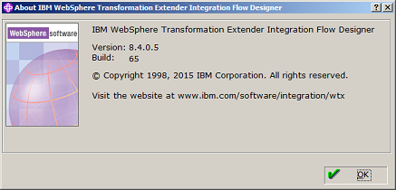

    Originally posted by: Nablokov
    Thanks for your help,
    To Paul : The sofware is installed with administrative privileges but I am not administrator. My version :
    To Laurent : Everything is by default, I'm using source map (if I compiled the map it doesn't change nothing)
