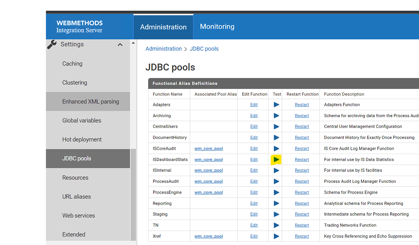

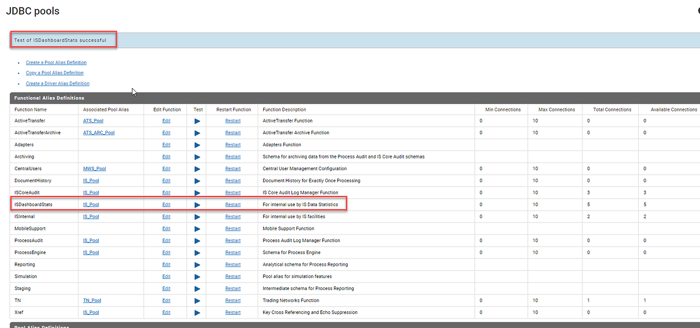

    go to IS admin ui => Settings => JDBC pools. then click the play button right next to ISDashboardStats pool to test db connection. If it is not assigned to a pool alias, you need to assign it.
    It is probably going to fail with an error message. My guess is the tables aren’t created for this pool or the pool/connection string has a typo/error or it is not set.
    If it fails and if you don’t know how to fix that error, share that output and server.log entries here.
    note: BTW, don’t change everything according to my screenshot. It is a POC machine, it doesn’t have a valid configuration.

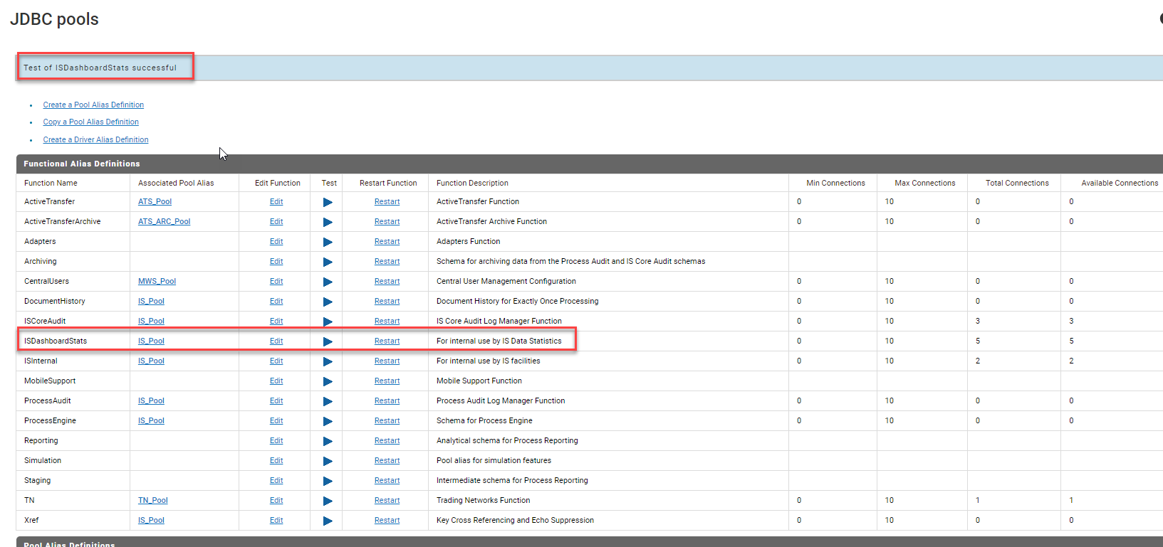

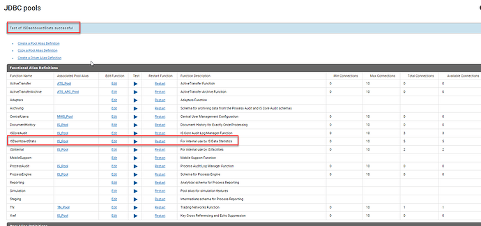

    Hi Engin/Nagendra, Thank you for your response. JDBC Pool setup looks good. I was able to test it successfully as you can see in below screen shot. Please see attached server.log
    server.log (10.6 KB)

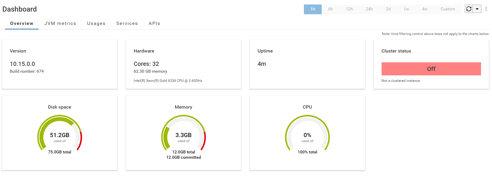

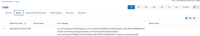

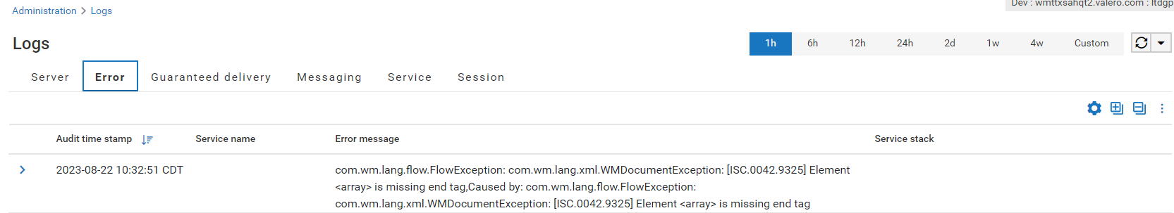

    The logs shared are the server logs, there is not enough information to figure out the problem, could you also share the error logs from the Administrator UI , Admin->Logs->Error ,

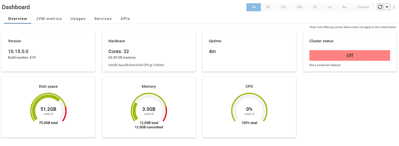

    Also do you see any issues accessing the IS Dashboard?

    I’m assuming that the error log entries also cover the time during which there were errors in the server log.
    If your dashboard is fine and the JDBC pool functional alias tests are fine, then it could have been a temporary connectivity/network related issue. I would suggest that you can monitor for such errors and raise a support ticket if this persists.
    -NP
