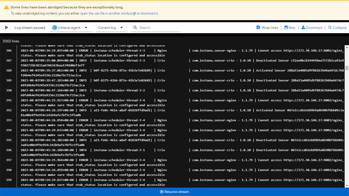

    Hi Everyone,
    I reserve two instance 'Cloud Pak for Integration on ROKS 4.10 Cluster (Custom)' and 'Instana - self deploy on VSI BYOK' on IBM TechnologyZone. After that I have install CP4I and Instana Operator from operators hub on Openshift Platform. Then I created Instana Agent with the value of endpointHost & endpointPort which I got from BYOK instance. The agent was successfully created and all the 5 instana pods were in running state. But they were not reflecting as agent in Instana dashboard. So when I check the logs of all the pods it showing error like "Cannot access https://172.30.146.17:8001/nginx_status. Please make sure that stub_status location is configured and accessible".
    Can anyone please help me with resolving this issue ?

    Hey Ayush,
    while there's not enough info to know for sure why you don't see the agents, I can tell you the Ngnix message is unrelated. This just means you have nginx running, but we cannot collect the metrics relevant to ngnix because we need to access nginx status, see https://www.ibm.com/docs/en/instana-observability/current?topic=technologies-monitoring-nginx#metrics-for-nginx for more info.
    When you say Instana Dashboard, which section of Instana are you looking at? It sounds like some connection/network issue, ideally I would suggest to open a Support Request with debug agent logs, expected behaviour, where are you looking for the agents, and so on, to understand where the missing piece is :)
