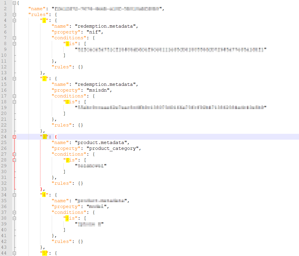

    I have investigated further, and I’ve reached the conclusion that only some types of requests fail, and I’ve pinpointed it to some specific characters, which I present below:
    The request below fails due to the characters that are highlighted, numbers and symbols like the dollar sign ($). I am aware that it is not standard to define numbers or symbols as the first character for a JSON Property Name, but this provider only has these fields available this way.

    2. In there, I was able to check that this error was being returned by the wsstack class, when trying to convert to XML, due to XML not accepting numbers and/or symbols as an element name (which is compliant with XML Rules/Norms);
