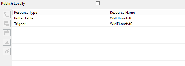

    I’m getting the following error when i try to enable my update adapter notification:
    [ART.116.3038] Adapter Runtime (Notification): Error in Notification Callback:enableCallback notification DPW_SAGE.adapters.DBNotification:sagePaymentUpdate.
    [ADA.1.349] Execution of DDL query of Notification failed during enable/disable. Please check the datatypes of columns selected in notification.
    Column name ‘WM_ROWID’ does not exist in the target table or view.
    attached is the screen shot for the adapter

    We are using SQL database, and all the columns i selected are nvarchar. no blob or clob on the table.
