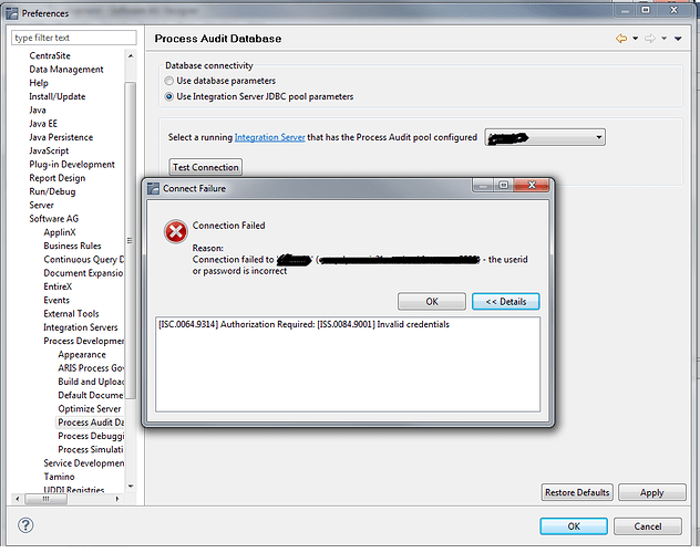

    Hi,
    I am trying to connect Process Audit database in Designer 8.2.1 using Integration Server JDBC pool parameters but it throws the following error:
    “Connection failed to ‘server’ (XX.XXX.XXX.XXX:5555) - the userid or password is incorrect [ISC.0064.9314] Authorization Required: [ISS.0084.9001] Invalid credentials”
    So I tryied to test it from Integration Server UI with the functional alias “ProcessAudit” and it succeed, and also I tryied entring the parameters used with a successful result.
    Do you have a clue why is failing?
    Should I apply some extra configuration in Integration Server?
    Thanks

  • 4.  RE: Error configuring Process Audit database in Designer - [SOLVED]
    Posted Wed February 19, 2014 12:42 PM
    Hi Douglas,
    Please attach the screenshot of designer set up page.
    Thanks,
    Rankesh

  • 5.  RE: Error configuring Process Audit database in Designer - [SOLVED]
    Posted Wed February 19, 2014 05:53 PM
    I come up with a temporal solution. The problem is that for some reason was not allowing to connect with the credentials used by me to connect to Integration Server through Designer. My user belong to Administrator and Developer ACLs so I do not understand why this is happening. I test it with default users (Administrator, Developer) and worked.
    The error message choosen by SAG is confusing, leading you to think that you entered bad user/password when the reality is other. My user and password are not incorrect otherwise I will not able to connect through Designer and perform regular tasks.
    In server.log I am getting " [ISS.0053.0002C] Access denied for user xxxx.xxxx on port 5555 → ‘wm-message’ "
    Do you know what I need to do to enable my user performing this task?
    Thanks Rankesh
