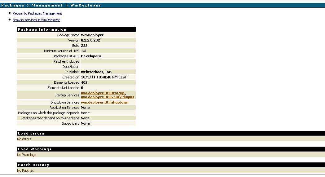

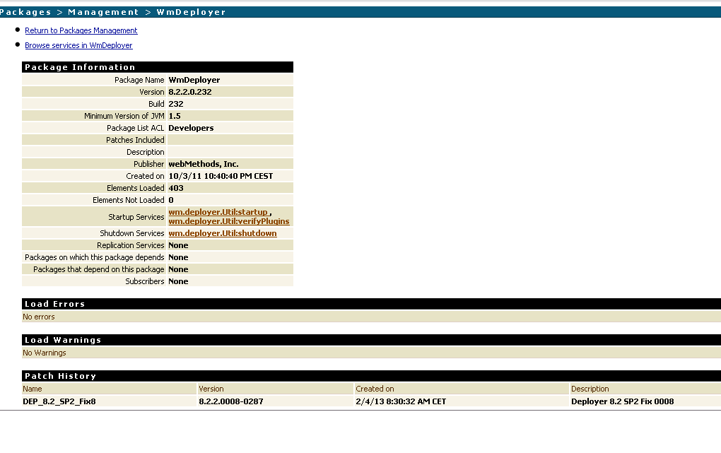

    This is the patch we have installed (using UpdateManagerCMD.sh)
    Fix 8.2.2.0005-1014
    We do not see any patches later/newer than this, if these aren’t the latest.
    I have attached screenshots of 2 environments we have here,
    a) Environment A - that is built by the webMethods team
    b) Environment B - that we built
    On Environment A, the patch DEP_8.2_SP2_Fix8 was applied and listed as shown. Whereas we do not see the same on Environment B.
    Appreciate your help.

  • 10.  RE: Error Adding MWS to Deployer
    Posted Thu June 06, 2013 07:19 PM
    So are you planning to install any fixes on Environment B as well?
    which environment is working vs not working just to understand clearly?
    Did you contact SAG support to open SI on this?
    HTH,
    RMg

  • 11.  RE: Error Adding MWS to Deployer
    Posted Thu June 06, 2013 10:29 PM
    Hi rmg,
    We got it resolved.
    The issue was we were installing the updates to /SUM which the updatemanager.cmd defaults to. We changed this to /IS for Integration server, /OPT for optimize server etc…
    Thanks for your help!
