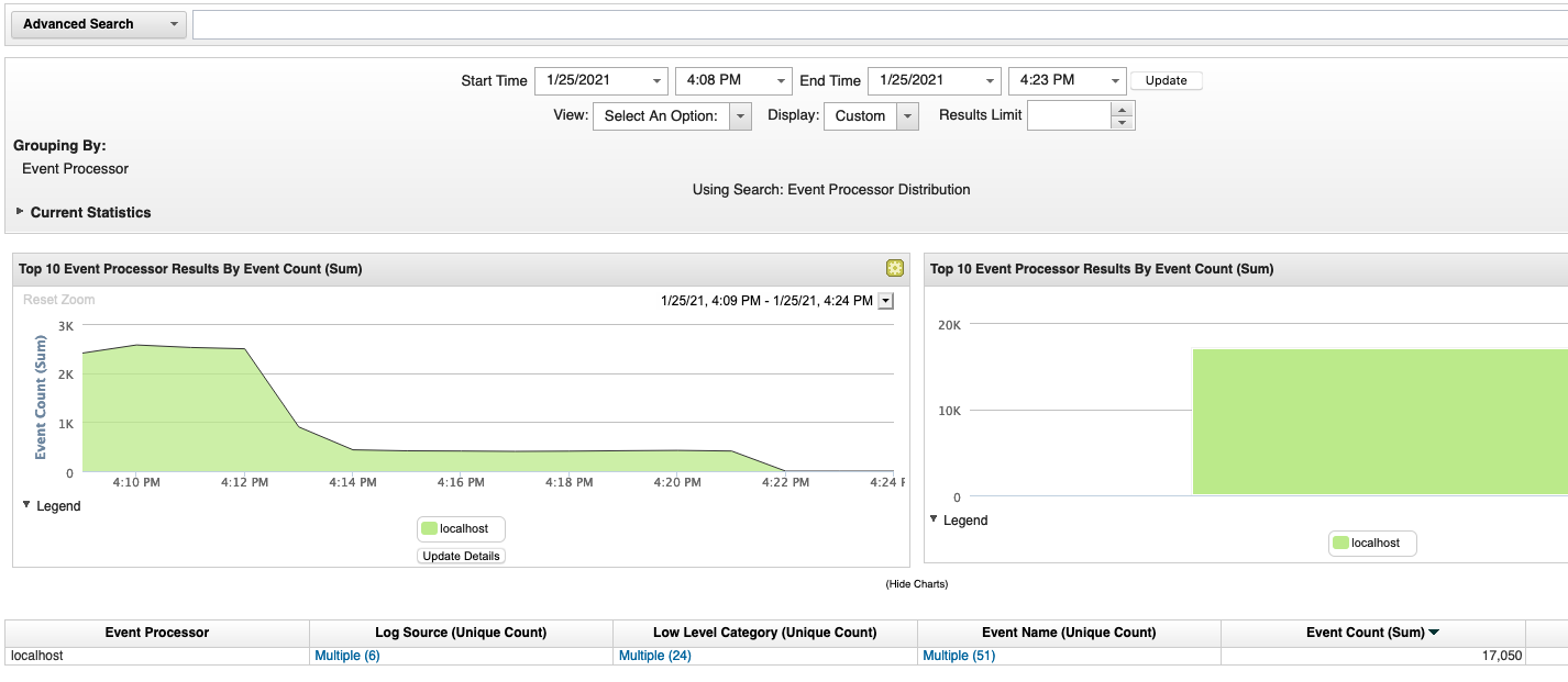

    Are you seeing events dropped from the pipeline or license exceeded? There are 100 different error scenarios. Pls provide event counts for each minute and error message you see to enable community to help you. Use time line graph like the one above and walk to the peak using mouseover data.
