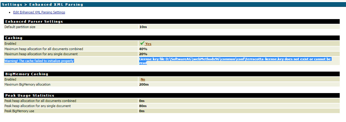

    but i do not own a terracotta license. Can i still use advantages of Enhanced Xml Node ?
    When i try to activate only Cache (no BigMemory) under IS → enhanced XML parsing i got
    the message “License key file D:\SoftwareAG\webMethods96\common\conf\terracotta-license.key does not exist or cannot be read”
    See screenshot attached.

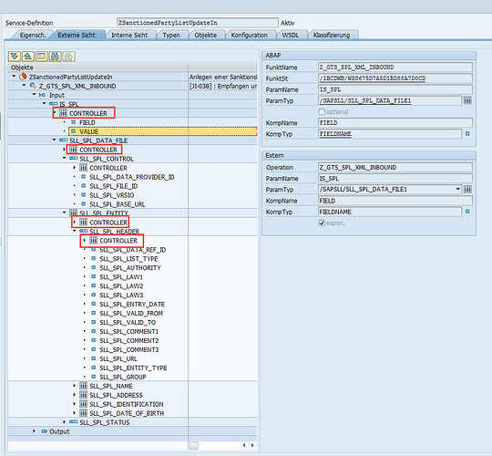

    We are using SAP GTS. We must upload XML Sanction Party Lists (SPL) provided by a Data Provider into the System.
    We would like to use a standard webservice from SAP.

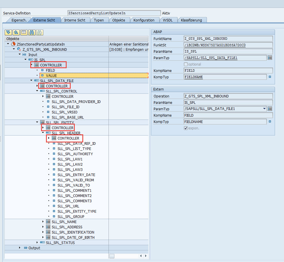

    The webservice expects the same structure, except the fact that it need the additional element CONTROLLER.
    (see screenshot)
    Also all empty fields have to be set to zero. But the pipeline “forget” these empty elements.
    So i have to through the Xml document and set the CONTROLLER element and some validations on the fields.

    Hi Sebastian,
    most likely you will have to get this changed in SAP, then re-export the WSDL from there and re-import in webMethods.
    If the field is really required, it should be allowed to be “null” (empty).
    Regards,
    Holger
