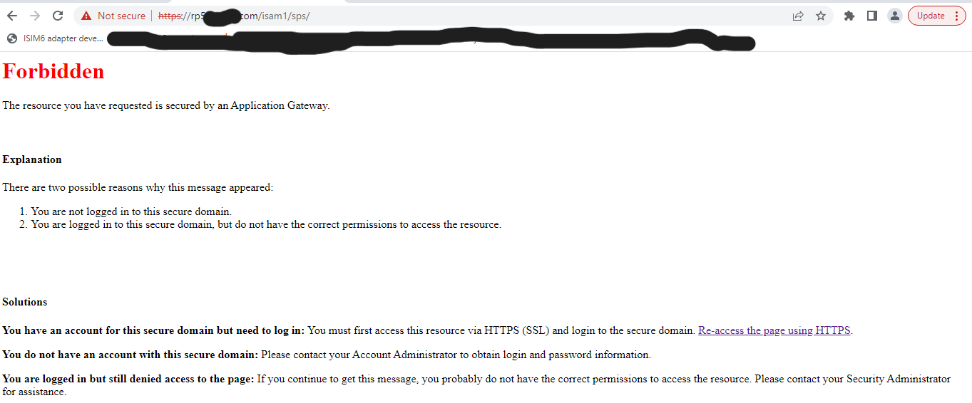

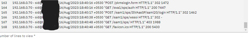

     We are able to create the junction via IP instead of hostname but now we are getting the Authorization error. Does it require any ACLs to be attached to this junction created for ADFS?
    Attaching images of forbidden error and request.log file:

    So, it sounds like you had a DNS issue in your environment.  As far as the ACL goes, when accessing the junction for a normal GET request the 'r' bit is required for the user who is accessing the resource.

    we have attached ACL also and assigned Read permission also but still facing the same issue.
