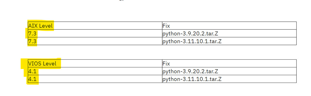

    I'm looking at this:
    Security Bulletin: AIX/VIOS is affected by a denial of service (CVE-2024-8176) due to Python
    I ran the recommended lslpp -L | grep -i python3.9.base  and even tried lslpp -L | grep -i python3.11.base.  Both returned nothing.  I even tried lslpp -L | grep -i python and that returned nothing either.  I was curious if I might have python but it might be so old as to be open to even other CVE's, etc.
    Does this mean that I don't have python installed and I can ignore that for now?

    Hi,
    If no output is generated that means python is not installed there. Additionally, the security bulletin referred here seems to be impacting only VIOS version 4.1 and AIX 7.3 version.

    HI ,
    VIOs 4.1 and AIX 7.3 the affected level foe this CVE

    Python isn't part of the base install of AIX 7.2 or VIOS 3.1.x.x.  It is part of the base install of AIX 7.3 & VIOS 4.1.x.x.
    As an aside, the commands you are running are looking for specific Python filesets, if you were to run "lslpp -L |grep -i python" then it would return any installed python fileset.  It's also possible to have Python installed from the Open-source toolbox, which you'd check with "rpm -qa |grep -i python".
