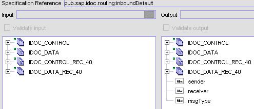

    STEP 1: Create a service to handle “content-based routing”. Name this service whatever you like, and put it somewhere where you put “common” services for server administration.
    STEP 2: On the “Input / Output” tab, select the specification reference at “pub.sap.idoc.routing:inboundDefault”.

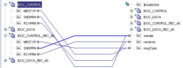

    Step 3: Create a map step
    Step 4: Add a string variable “$routeOnly” and set the value to “true”
    By inserting the parameter “$routeOnly” with the value “true” prior to calling WmPartners, logging to disk is bypassed.
    Step 5: Map “sender”, “receiver” and “msgType” from IDOC_CONTROL as follows (you will have to create the variables on the left under IDOC_CONTROL): (Note that this step is necessary if you use IDocs that are a version earlier than 4.0)
    SNDPRN => sender
    RCVPRN => receiver
    MESTYP => msgType
    On each of these three maps, edit the “Indices” to use “IDOC_CONTROL” index “0”, and insert a “Copy condition” ensuring that the variable being copied is not null (the following image is an example):
    Step 6: Repeat step 5, only for IDOC_CONTROL_REC_40.
    Steps 5 and 6 emulate the default behavior of the SAP adapter by extracting sender, receiver, and message type from the EDIDC
