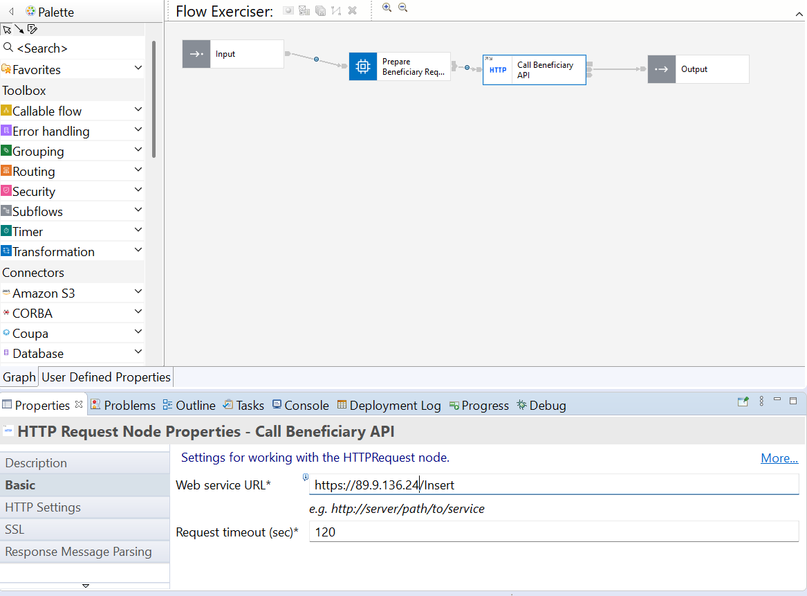

    I try to call the https API without any certificate using the HTTPRequest Node, but it returns the following error
    BIP2230E: Error detected whilst processing a message in node 'gen.SubmitBeneficiaryObject.submitbeneficiary (Implementation).Call Beneficiary API'. \nBIP3162S: An HTTP error occurred. The HTTP Request-Line was: 'POST /InsertMODBeneficiary HTTP/1.1
    \nBIP3152S: Socket error detected whilst invoking Web service located at host 66.9.136.35, port 443, path /InsertMODBeneficiary. \nBIP3165S: An error occurred whilst performing an SSL socket operation. Operation: connect. Error Text: javax.net.ssl.SSLHandshakeException: com.ibm.jsse2.util.j: PKIX path building failed: com.ibm.security.cert.IBMCertPathBuilderException: unable to find valid certification path to requested target.
    I need to disable the validation for the certificate.

    I comprehend you, but I need to describe the point when I tried to call the backend directly from Postman without passing any certificate. It was working fine, but when I tried to call from App Connect, it returned an error for SSL. I didn't know the reason, but in case I tried to change the URL in HTTPRequestNode to another HTTPS URL, it worked fine also.
    You get my point?
