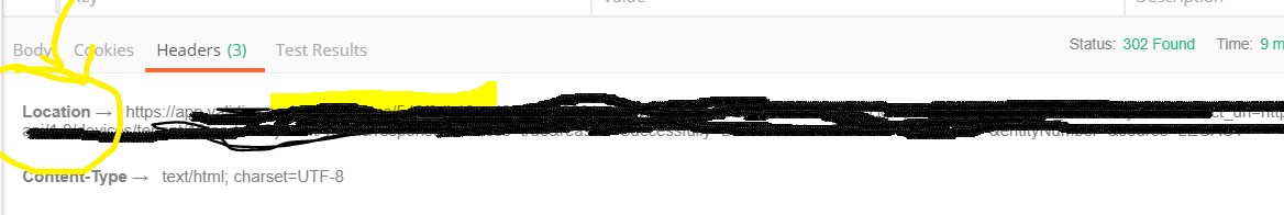

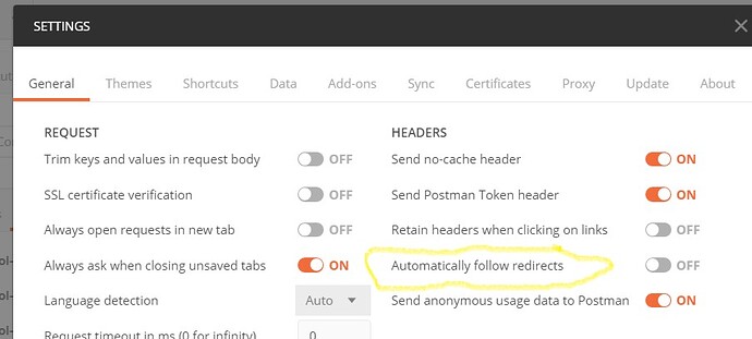

    Hello All,
    Is there any config/setting to restrict Auto Follow Redirect in wM while making pub.client:http call?
    Scenario:
    While making Rest service call, Back end system passing Location param in header to redirect url which needs to be disabled in wM.
    Currenly I’m Using wM IS 10.1 to implement this.

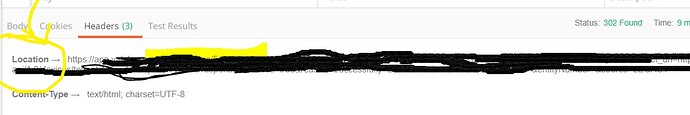

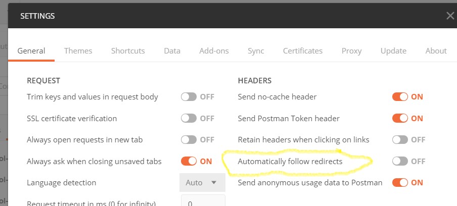

    When i tried hitting back end system from postman, there is a setting to restrict Auto Follow Redirect. By using that setting, i could restrict the redirection and in turn see “Location” Param returned in the response header. [ Refer Attached Postman-Restrict-Autoredirect-Setting.jpg & Attached expectedResult.jpg ]
    If i enable it, Redirection happens and could see the html page in the Response body [ Refer Attached Postman-Enable-Auto-Allow.jpg]
    Same way,
    Disable Auto Redirect needs to be implemented in wM pub.client:http call. By default, it is redirecting and giving html content in the response.
    Any possibility to restrict it and get the Location Param in the Http Response Header [ Refer Attached expectedResult.jpg ]
