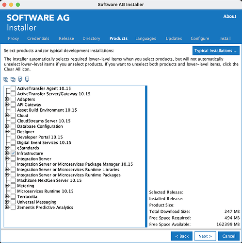

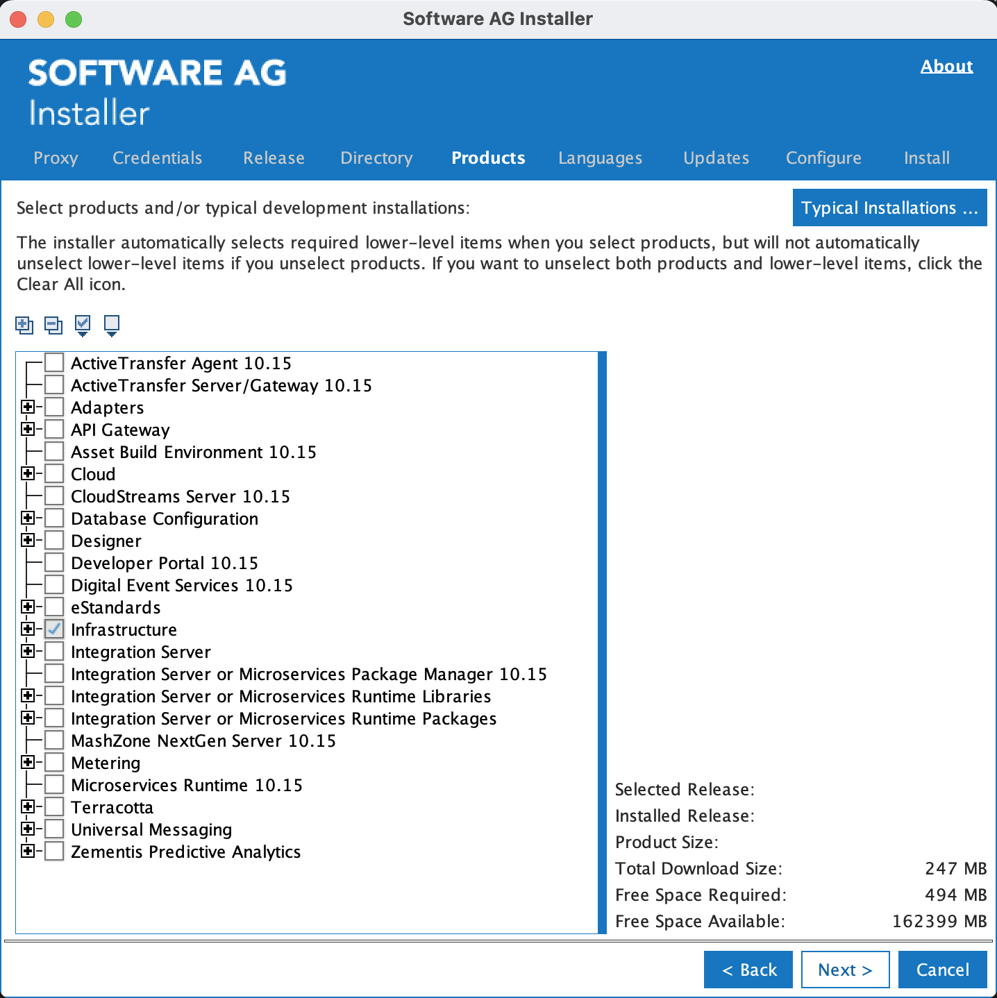

  • 9.  RE: Disable API Gateway from primary Integration Server instance
    Posted Sun May 19, 2024 08:53 AM
    I am afraid this isn’t the case. I am a webMethods presales and I believe I know these products very well.
    The Tech Community article you’re referring to is 7 year old!
    If you choose “API gateway” in the installer, then you get an API GW that embeds an IS and this IS needs to be used together with the API GW.
    If you choose just the IS, then you get a runtime that does not include the API GW features.
    See by yourself in this installer screenshot:

  • 10.  RE: Disable API Gateway from primary Integration Server instance
    Posted Tue May 21, 2024 04:47 AM
    Hi Stephane,
    but you can select both of them in the installer, when you are licensed for both (via different license files obviously).
    In this case this is just a question to apply the proper license file for the each of the installation.
    And not to select the API Gateway parts for the regular IS/TN installation, of course.
