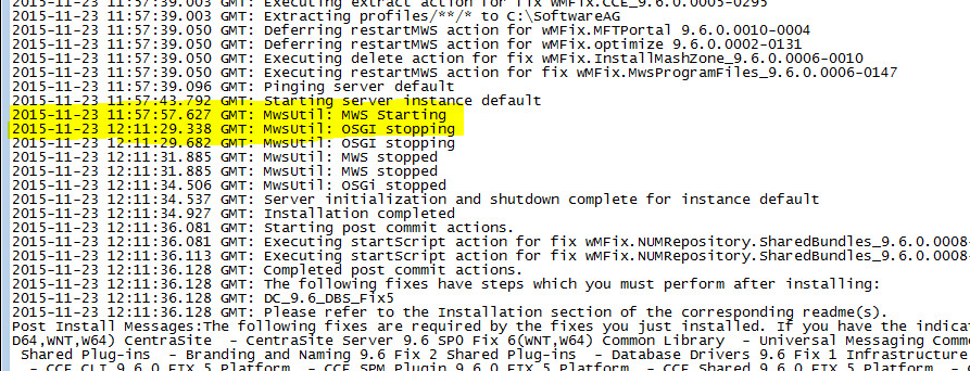

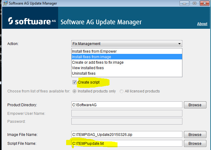

    My experience using the GUI was this:
    1. Set Image path (for update.zip) - see attached
    2. Set Script path (to generate script) - see attached
    3. Select all fixes. At this point, just before the installation, I get warnings that I need to perform pre-installation steps for fixes x, y and z. When I try to click on the fix and click the Readme button, I just get a message saying no readme available for this fix.
    4. At the end of the GUI update installation, Update Manager informs me that x, y and z fixes could not be fully applied due to a, b and c reason. But otherwise it is a successful update.
    5. Once the wizard is closed, the script is not generated.
    The way I got round this was to use the UpdateManagerCMD.bat (C:\SoftwareAG\UpdateManager\bin)
    Using that, you can answer the same fields as with the GUI, including path to script file, but this time it will actually generate a file at the end of the installation.
    After that you can use -readScript with the same batch file to run a silent installation.

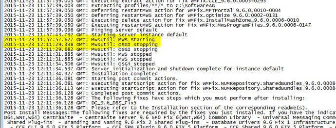

    I know other people will likely have a different experience. I found that the install (osgi?) process normally struggles to restart the MWS service right at the end of the installation - and this can leave the install hanging indefinitely. But at least the installation appears to be complete by that stage, and the service can be restarted manually.
    You can see the point in the update log where the time gap occurs (highlighted, attached). The log resumes after a manual restart of the MWS service.
    Isaac

  • 7.  RE: Dev Suite 9.6 Update Manager Create Script Silent Install
    Posted 11/25/15 10:42 AM
    Hi,
    thanks for your replies.
    @Isaac:
    Can you share the complete version of your update manager (from About Dialog)?
    There have been certain Fixes for UpdateManager itself causing the Auto-Update feature to break.
    Additionally there have been issues where applying Fixes to MWS took too long when preparing them for usage.
    This was some sort of an timeout issue between UpdateManager and MWS:
    1. After UpdateManager has extracted the Fixes for MWS/OSGI, the MWS is started once to update the portlets.
    2. After this is finished the MWS shuts down and the UpdateManager completes.
    3. After exiting the UpdateManager, the MWS can be started again.
    In the cases, where the UpdateManager fails during this, the MWS has been shut down, but the UpdateManager did not pick up this event, timing out during this.
    Affected versions of UpdateManager 8.2.1 were Fixes 40 thru 50. If you was able to update the UpdateManager beyond this point the described issues (except for the time gap, this is technical related) should not occur any more.
