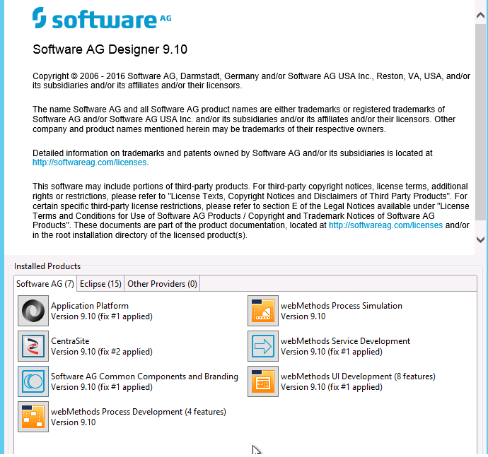

    Hi All,
    We are currently on 9.10 webMethods. We are currently trying out Automatic build and deployment.
    We have Git Plugin installed on Designer. We are not able to do check-in check-out from Git to designer as we are not getting the option "Create Local Service Development’ when we click on packages.
    Attaching the latest Fix details on Designer.
    Please suggest.

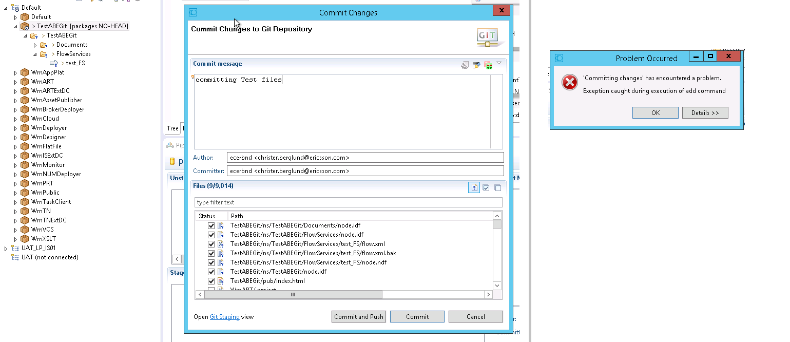

    Posted 08/12/16 05:48 AM
    Thanks Mahesh for your reply.
    I’m able to get option ‘LocalServiceDevelopment’ now but not able to commit to Git repository.
    I have cloned the git repo on designer . URL which i have used is - xmonshe@bitbucket.platform.dev.sdt.ericsson.se/scm/sdis/testabe.git">https://xmonshe@bitbucket.platform.dev.sdt.ericsson.se/scm/sdis/testabe.git.
    Attaching the screenshot of designer and the error which is popping out.
    Please suggest
    Thanks,
    Monica

    Hi Monica,
    what is the detailed Exception description?
    Eventually this might help in analysis.
    Regards,
    Holger

    Thanks Holger and Mahesh for the responses.
    We need to delete index.lock file which was preventing for commit.
    After deleting I was able to commit.
    I refereed the link - Eclipse Egit Failed to commit - Stack Overflow
    Regards,
    Monica

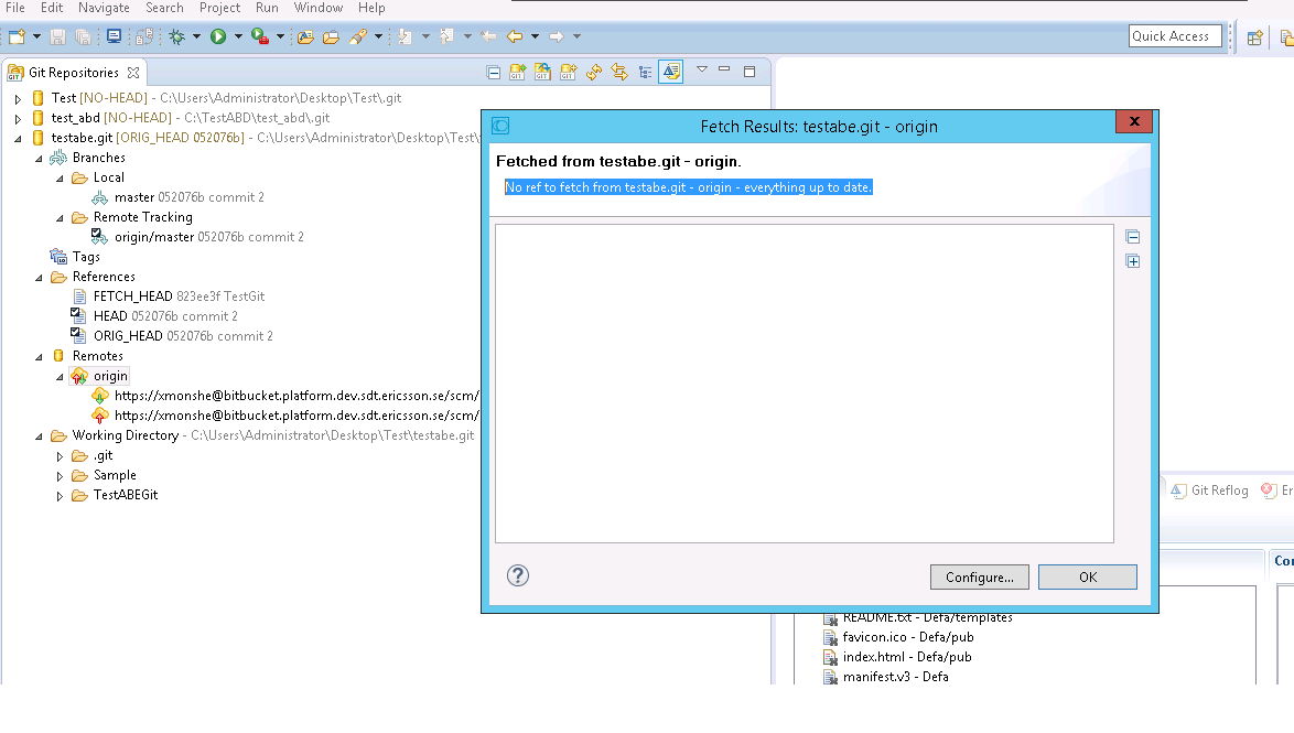

    Hi All,
    Can anybody suggest how do we do a check-out from Git repo through designer .
    I tried both the option - ‘pull’ and ‘fetch upstream’ but getting the message as “No ref to fetch from testabe.git - origin - everything up to date.”
    Attached screenshot for reference.
    Regards,
    Monica
