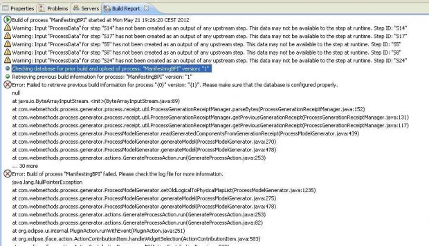

  • 4.  RE: Designer build error
    Posted Fri May 25, 2012 08:16 AM
    Designer version : 7.2 and 7.1.2
    IS version : 7.1.2
    Attached to this reply is a screenshot of the error
    Thanks
    Jeremy

  • 5.  RE: Designer build error
    Posted Fri May 25, 2012 08:20 AM
    in Designer, go to Windows > Preferences > SoftwareAG > Process Development > Process Audit database, do you see Process Audit Pool configured? Is the ‘Test Connection’ success?
    -Senthil

  • 6.  RE: Designer build error
    Posted Fri May 25, 2012 08:56 AM
    Hello Senthil,
    thanks for the answer to Jeremy - I am handing this over from him. I have checked the setup - it is using Integration server JDBS pool parameters and the test connection was successful.
    Thanks!
    Jana

  • 7.  RE: Designer build error
    Posted Fri May 25, 2012 09:58 AM
    Hmm… Can you execute the scanPackage service by mentioning the package name created by the process model? This will recheck the fragment file and correct it if required.
    As it is null pointer exception, want you to check these options. Were you able to build process models before, and now it is giving this problem, or is this the first time?
    -Senthil

  • 8.  RE: Designer build error
    Posted Fri May 25, 2012 10:33 AM
    Actually, I think this has something to do with the database upgrade. We were rebuilding the processes before without problems also we have reproduced the error on two computers, in two different Designer versions and for several different BPMs - looks that some DB connectivity doesn’t work, but not sure where to check. The BPM process and its steps are stored in DB after the first build (which is successful). When doing the second build we get this error.
    Also, not sure if this has the same root cause, but when the first build has been done it could not be administrated (and activated) through the WM Portal administration due to below error (not found any problem though - anything missing). I have activated the process directly in DB and it was successfully processed and shown in the WM Portal monitoring.
