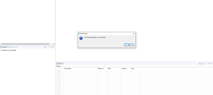

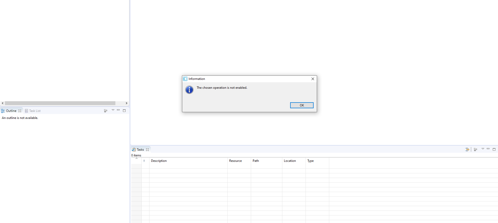

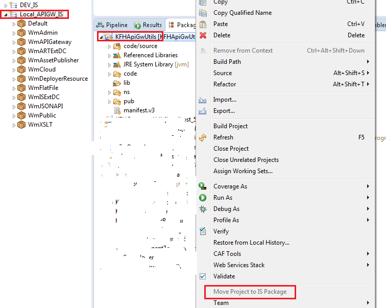

    Hello everyone,
    I’m unable to move project to IS package on APIGateway integration server, But it is available for webMethod integration server. Both are installed in local machine.

  • 2.  RE: Designer 10.5: move project to IS package disabled
    Posted Mon March 15, 2021 07:36 AM

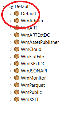

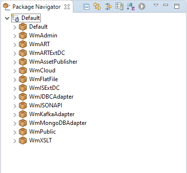

    Hi,
    As per the screenshot from your query, I can see that it’s not local development capable Integration Server. The local service development feature works with the local development server only i.e. Integration Server & Designer should be from the same installation folder. Connecting Designer to any other installation’s Integration server will treat it as normal Server & the related actions will be disabled. When you connect to the proper Local Development Integration Server, you can see a “Bulls eye icon” (refer below screenshot) for the connected server in the Package Navigator.

  • 3.  RE: Designer 10.5: move project to IS package disabled
    Posted Wed March 24, 2021 10:39 AM
    Thanks a lot. It’s working after installing the designer in the same installation path.

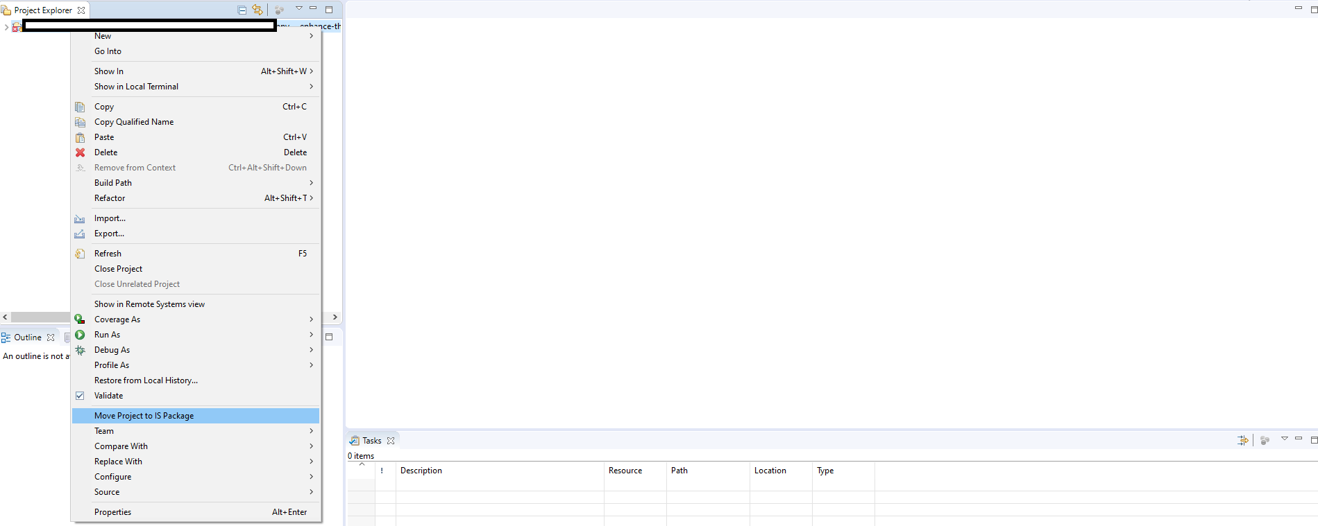

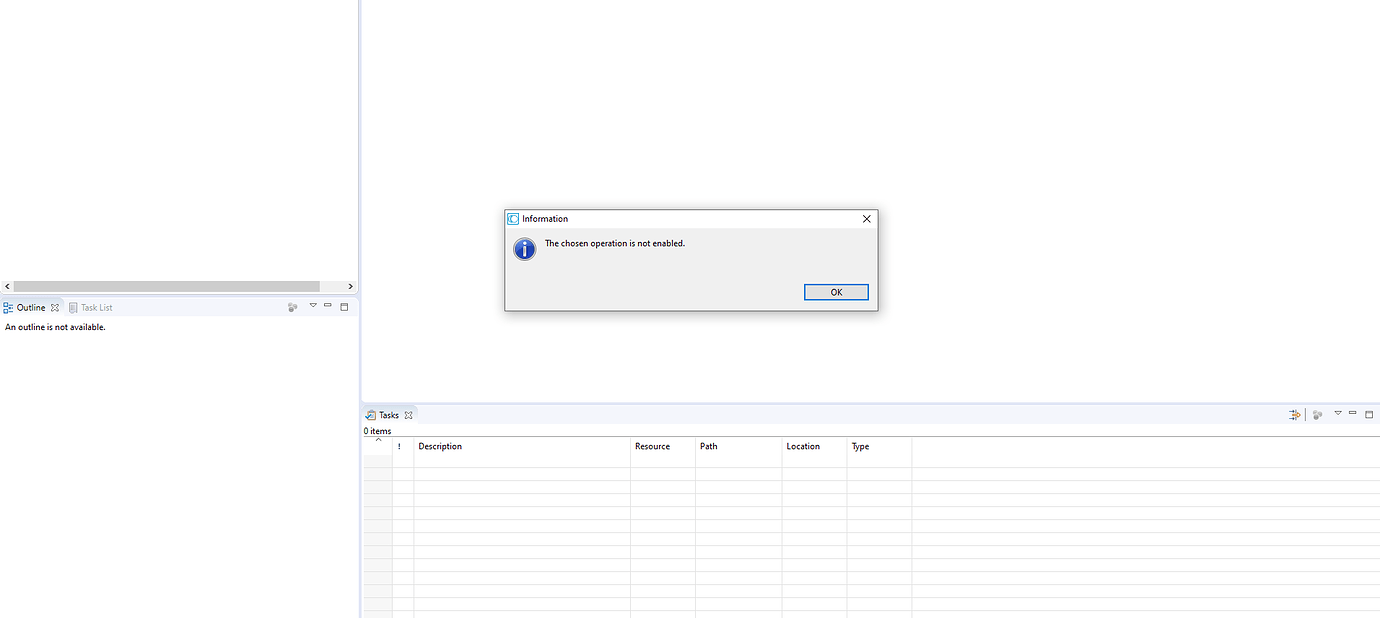

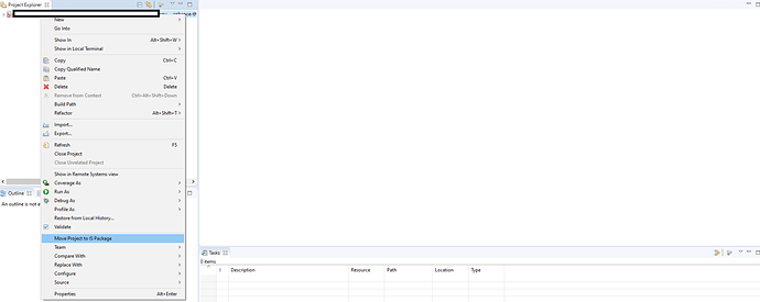

  • 4.  RE: Designer 10.5: move project to IS package disabled
  • 5.  RE: Designer 10.5: move project to IS package disabled
    Posted Wed January 12, 2022 08:28 AM
    Is this a remote IS (i.e., not on your machine, but accessed via a Designer on your machine) or a local IS on your machine with Local Service Development capability?

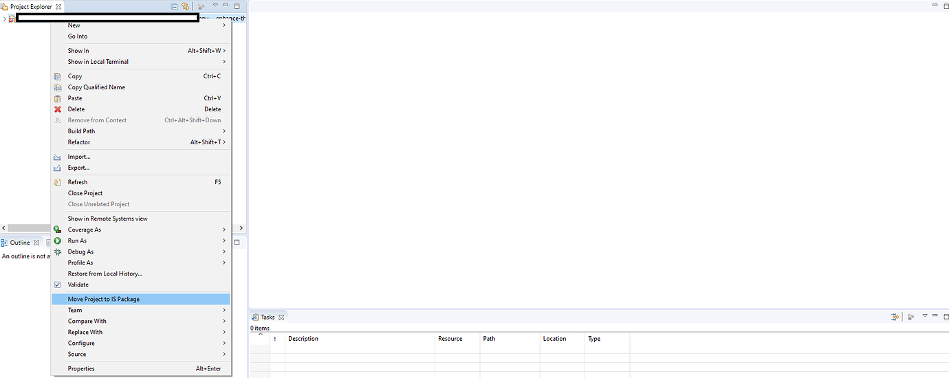

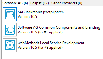

  • 6.  RE: Designer 10.5: move project to IS package disabled
    Posted Wed January 12, 2022 08:41 AM
    This is local IS with designer installed in the same directory, below is the screenshot of service perspective and installed plugin.

  • 7.  RE: Designer 10.5: move project to IS package disabled
    Posted Wed January 12, 2022 09:13 AM
    Hi,
    Mostly the checked-out project might not have required Java/Local Service Development compatible natures/builders, hence first you need to add VCS project nature to the packages that are not created in the local Integration & then you can try ‘Move Project to IS Package’ option.
    To do this, right-click the package in the Package Explorer view and select Configure> Convert to Local Service Development Project . This also adds the Java project nature to the package.

  • 8.  RE: Designer 10.5: move project to IS package disabled
    Posted Wed January 12, 2022 09:22 AM
    Hi Prashant,
    Thanks for the support. It’s working now.
