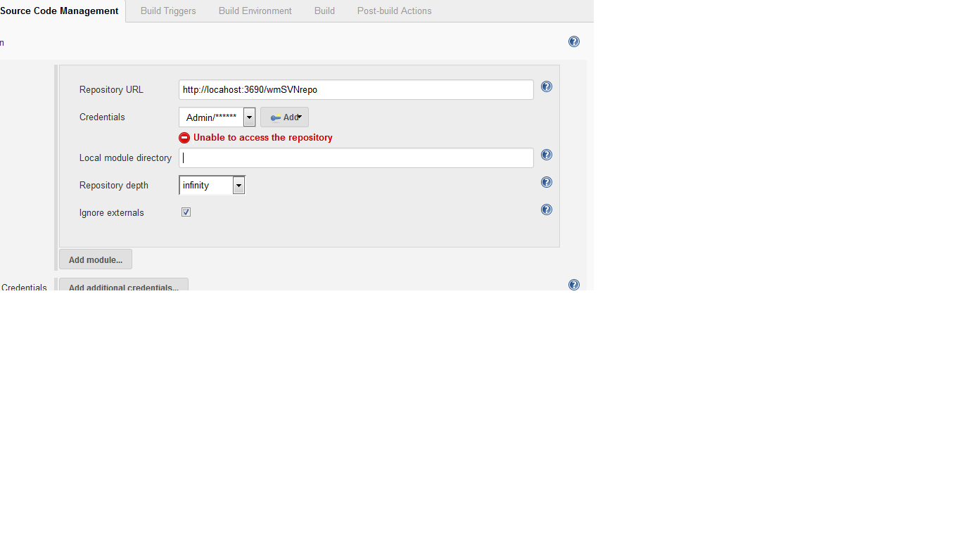

    Hi everyone,
     Currently I am doing POC on deployment using Jenkin.Both ABE and SVN are also used .
    I am getting an error “unable to access the repository” while configuring source code management section using Jenkins .
    SVN repository path is –http://locahost:3690/wmSVNrepo
    webMethods version–webMethods 9.12
    Using designer svn repository is accessible via svn://locahost:3690/wmSVNrepo .
    Can anyone please share your experience or thoughts on identifiying and fixing this issue .
    With Regards
    Sweta

    Hi,
    Typo: locahost instead of localhost ?
    Best regards,

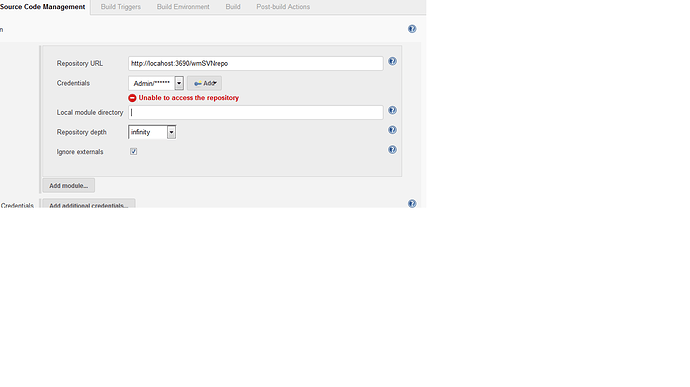

    Hi ,
    Thanks for identifying the typo .I attached the incorrect screenshot here .PFA the correct screenshot.which contains localhost instead of locahost. Still same error(“unable to access the repository”) exists .
    SVN repository path is –http://localhost:3690/wmSVNrepo
    Using designer svn repository is accessible via svn://localhost:3690/wmSVNrepo .
    With Regards
    Sweta

    Hi everyone,
    This issue is now fixed after removing the port 3690.
    SVN repository url–svn://localhost/wmSVNrepo.
