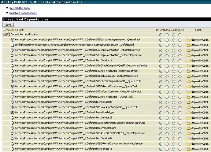

    Some checks dependencies warns me that there may exist problem. I choose “Exist” on those problem as the warning concern IS package which are already deployed on the target server.
    My first problem is that the list of dependencies is wrong.

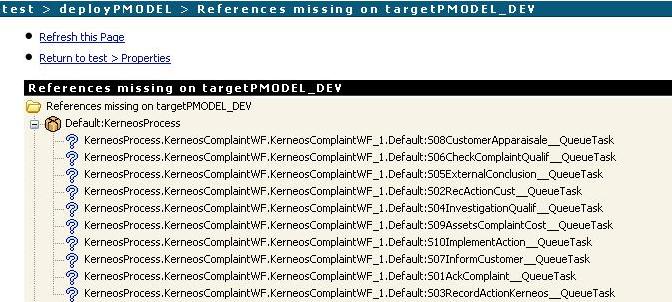

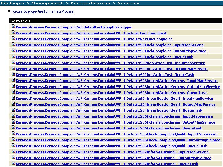

    In the “PackageManage.jpg” file you can see the content of the KerneosProcess package of the source server.
    Check in particular the name of all “QueueTask” flow service.

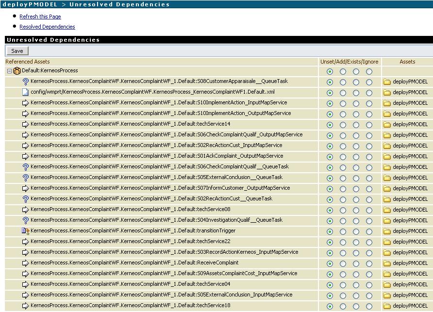

    Then check the “QueueTask_Flow.jpg”. All dependencies related to “QueueTask” flow service are wrong. They try to use a flow service containing two “_” in the name. Plus, it tells me that the type of the artefact is unknown.
    After saying it will exist on the target server all is OK and I can build and export it.

    If you check the “TargetServerMap2.jpg” you can see that only the “QueueTask” flow service are showing (with two “__”).
    Those flow service are correctly deployed in the target IS but with one “_” as they should.
