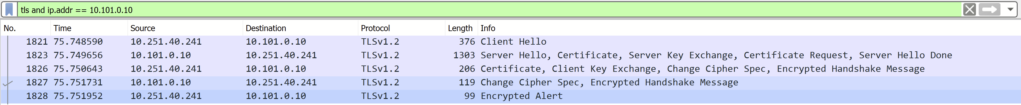

    I am struggling debugging a SSL connection.
    Here is what I have:
    • ISAM is the client, and LDAP is the server  (using LDAPS)
    • If I configure the connection to LDAP, everything is working fine, but if I use TLS it fails.
    I did a packet trace, and found the following, using wireshark:
    I can see that the handshake did not complete (message: Encrypted Alert), and it was in fact rejected by ISAM (in IP 10.251.40.241).
    I don't know why!
    How can I check what happened in ISAM for it to reject the TLS communication and never complete the handshake?
