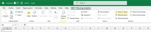

    Hi,
    I have a simple question.  What are the results if you go to the Planning Analytics tab and click on the "Rebuild Worksheet" and then the "Refresh Worksheet"?
