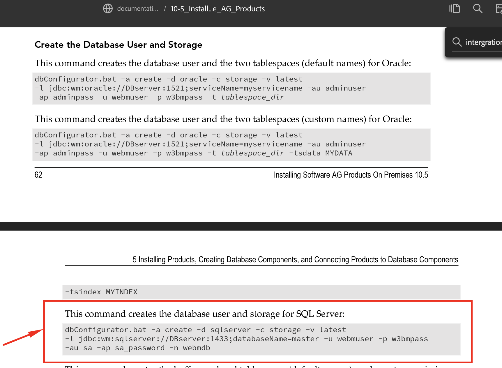

    I also run the below command as per the 10.5 doc but got the error
