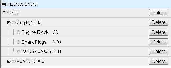

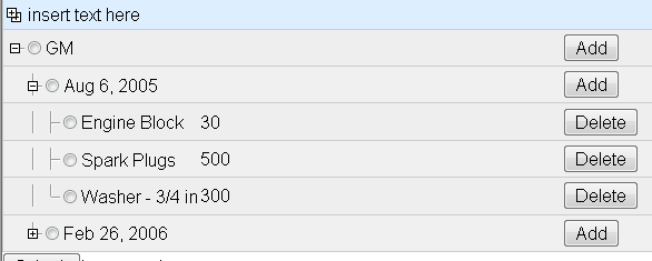

    I have two asyncButton(Add/Delete) attached with each row and they contains inside two hidable panel.
    Now dispaly properrty of the hidable property is set as
    #{test.widgetQuantity==null} dispaly panel with Add button
    #{test.widgetQuantity!=null} Dispaly panel with Delete Button
    Initial loading of the page is displaying correct display of the button.
    Now if I click on any of the button(Add/Delete) then page only dispaly that button only.
    I have attached the screen Shot for reference.
    Initially I was thinking this may be due to same ID to the same panel in all row.But this is not the case.
    Any advise how this can be resolved.
