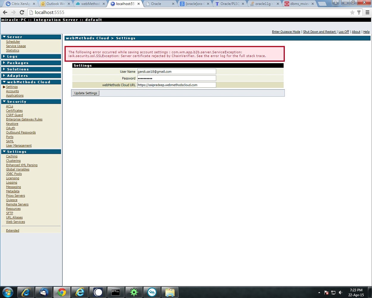

    Hello Experts,

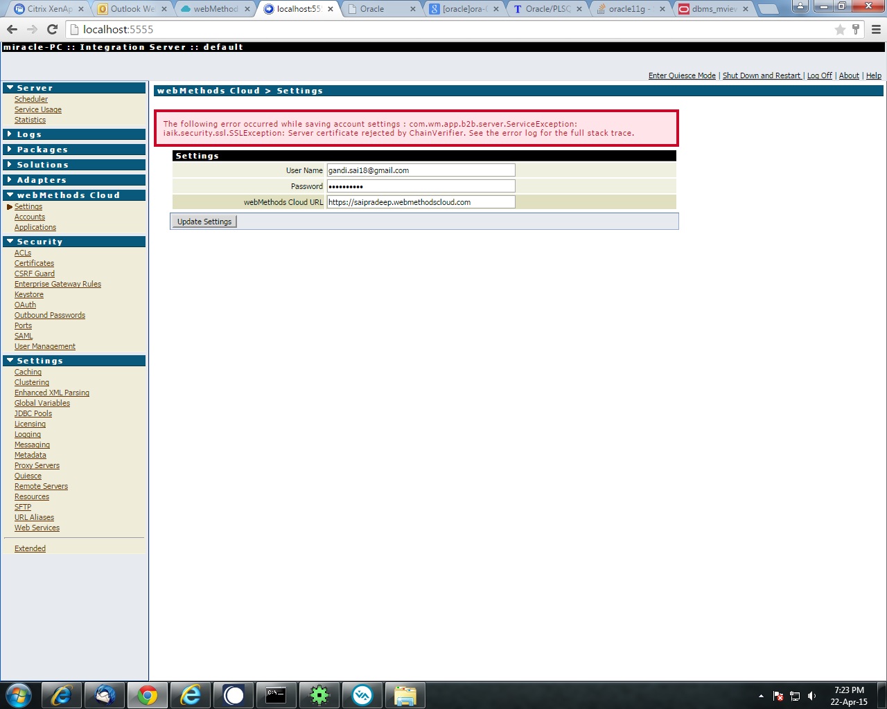

    I’ve registered in webMethods integration Cloud. And I was trying to update the username, password and webMethods Cloud URL under IS Admin Page → webMethods Cloud → Settings.
    But I’m getting the following error.
    “The following error occurred while saving account settings : com.wm.app.b2b.server.ServiceException: iaik.security.ssl.SSLException: Server certificate rejected by ChainVerifier. See the error log for the full stack trace.”
    Here I’m trying to add an on-premise account and an associated application to be upload into my webMethods Integration cloud URL.
    Can anyone please suggest me how to approach in a right way ?

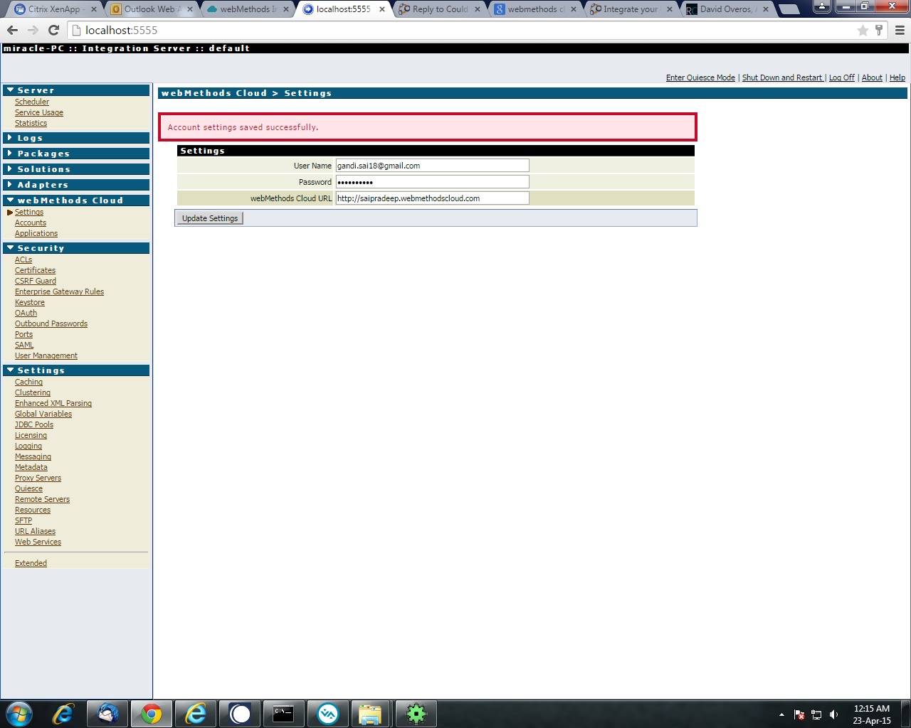

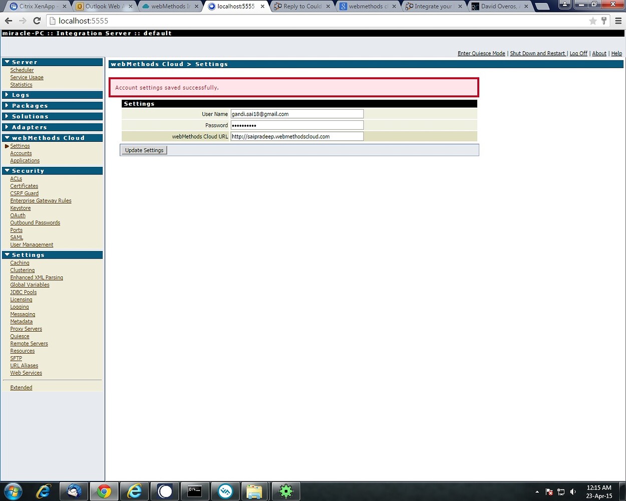

    Hello Experts,
    The account settings updated successfully after changing the protocol to http. Before that I used https connection. So that I was getting SSL exception.
    Thanks,
    -Sai Pradeep.

    Hello rmg,
    Actually, my wM Integration cloud account url is “https://*****.webmethodscloud.com”.
    But I’m wondering that the account settings were updated successfully when I changed the protocol to “http”. Is it the right way ?? Will this work out properly ?

    The error:
    means that your server doesn’t trust the system’s cert chain that you are connecting to.
    Get the cert chain (you can use browser to do it), and install the root and intermediate cert into your server’s trust store, so you can use https.

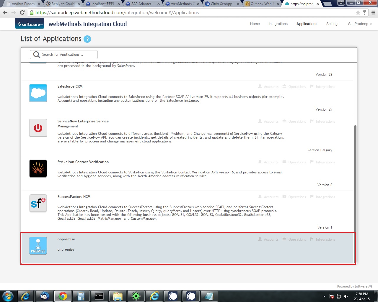

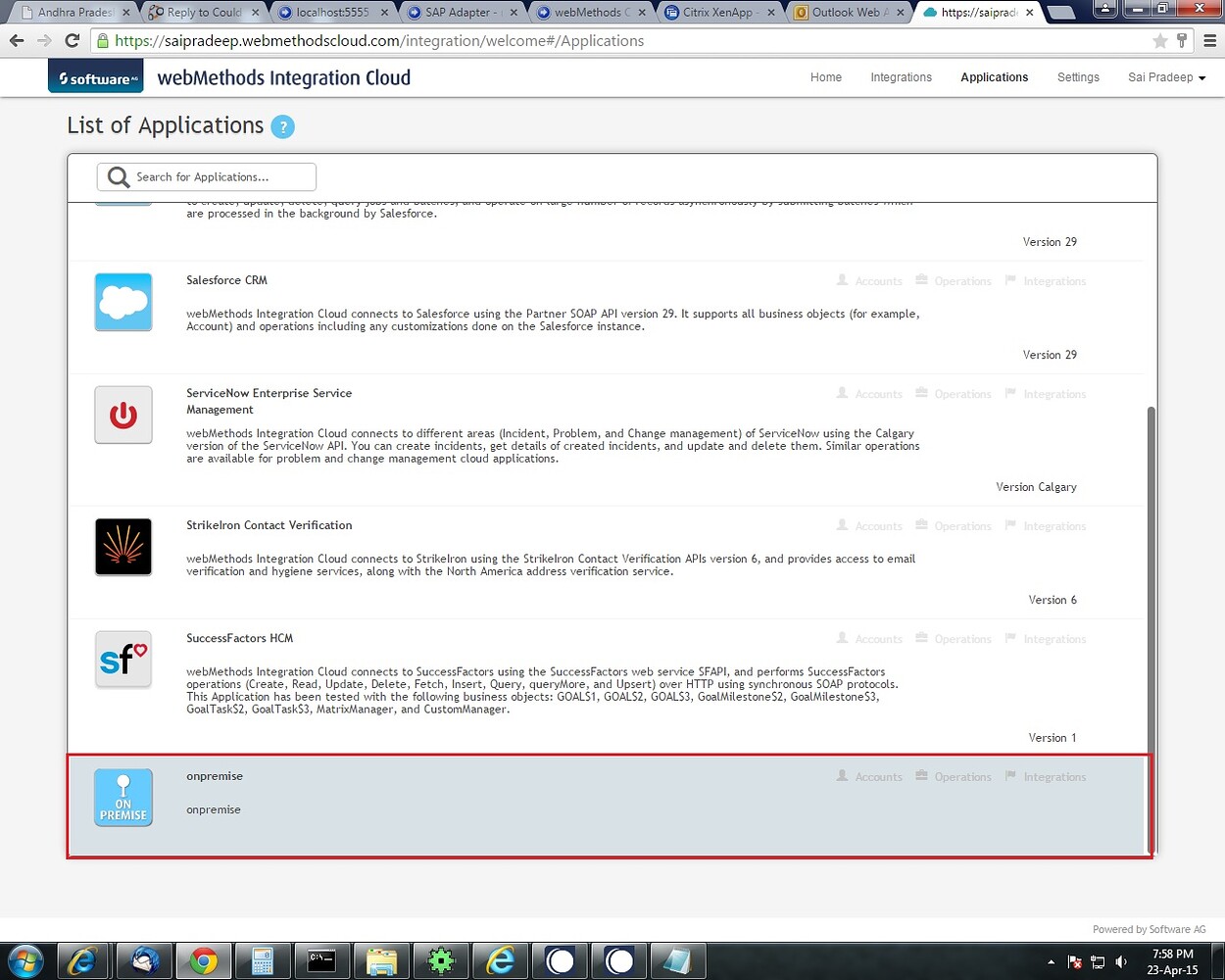

    Thank you very much for your valuable info. I extracted the certificates of the webMethods Integration cloud. But I was unable to configure certificates because I’m getting an error like “Could not import certificate: [SoftwareAG][Oracle JDBC Driver][Oracle]ORA-00942: table or view does not exist”. May be oracle scripts were not executed successfully. I will check out the solution and try installing them. But I could able to upload applications on to my cloud account using with http url also.
    Please take a look at the attached screen shot.

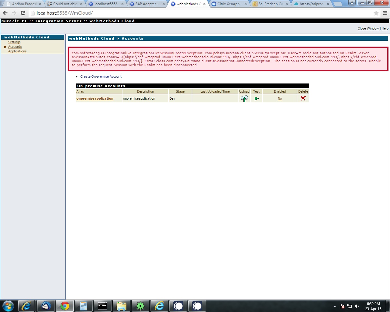

    I’m using Integration Server 9.7. And I didn’t apply any fixes to the WmCloud. My current wMCloud verion is 9.7.0.0.361.
    Currently, I’m facing a problem with enabling the On-Premise account. But, it’s not enabling even though my realm server is in up state as according to the below error. It’s throwing an error when I tried to enable onpremise account like “com.softwareag.is.integrationlive.IntegrationLiveSessionCreateException:com.pcbsys.nirvana.client.nSecurityException: User=miracle not authorised on Realm Server nSessionAttributes:conns=3/[nhps://chf-wmcprod-um001-ext.webmethodscloud.com:443/, nhps://chf-wmcprod-um002-ext.webmethodscloud.com:443/, nhps://chf-wmcprod-um003-ext.webmethodscloud.com:443/]. Error: class com.pcbsys.nirvana.client.nSessionNotConnectedException - The session is not currently connected to the server. Unable to perform the request:Session with the Realm has been disconnected”
    suggest me what to do to enable the On_Premise account in IS->webMethods Cloud->Accounts.
    PFA error screen shot.

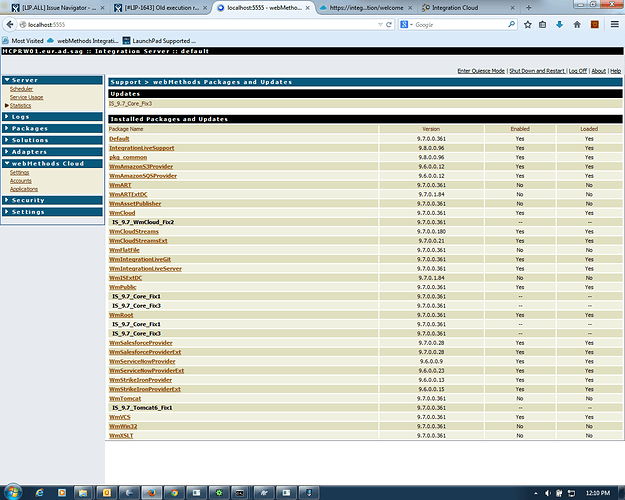

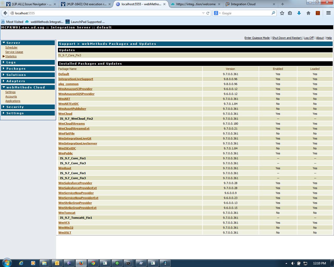

    Hi Sai Pradeep,

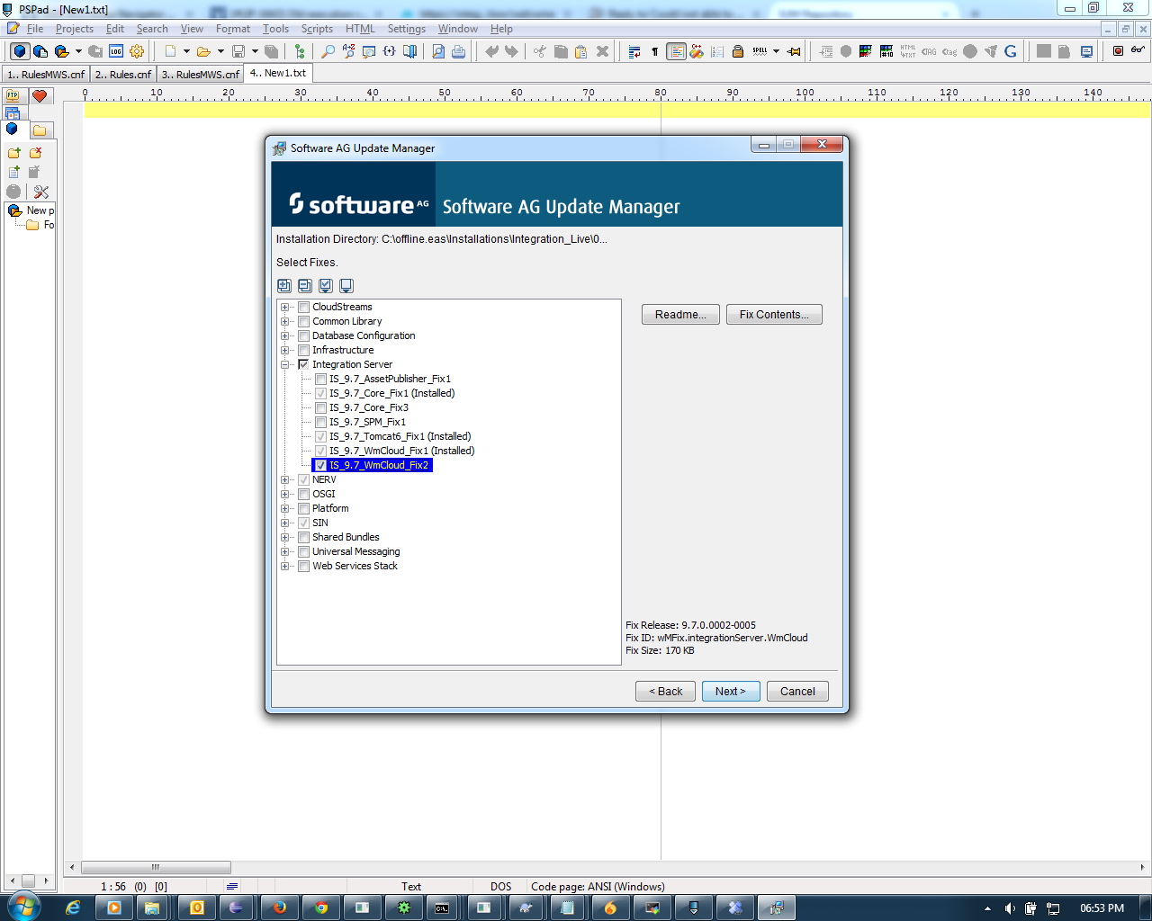

    Sorry but it is not possible to attach the fix here, you can install this fix using Software AG Update Manager.
    You can install the latest fix from empower itself.
    Please see the attached Software AG Update Manager screenshot, or you can find more info on how to use Software AG Update Manager on Software AG documentation.
    Hope this helps.
    Thanks,
    Pradeep.

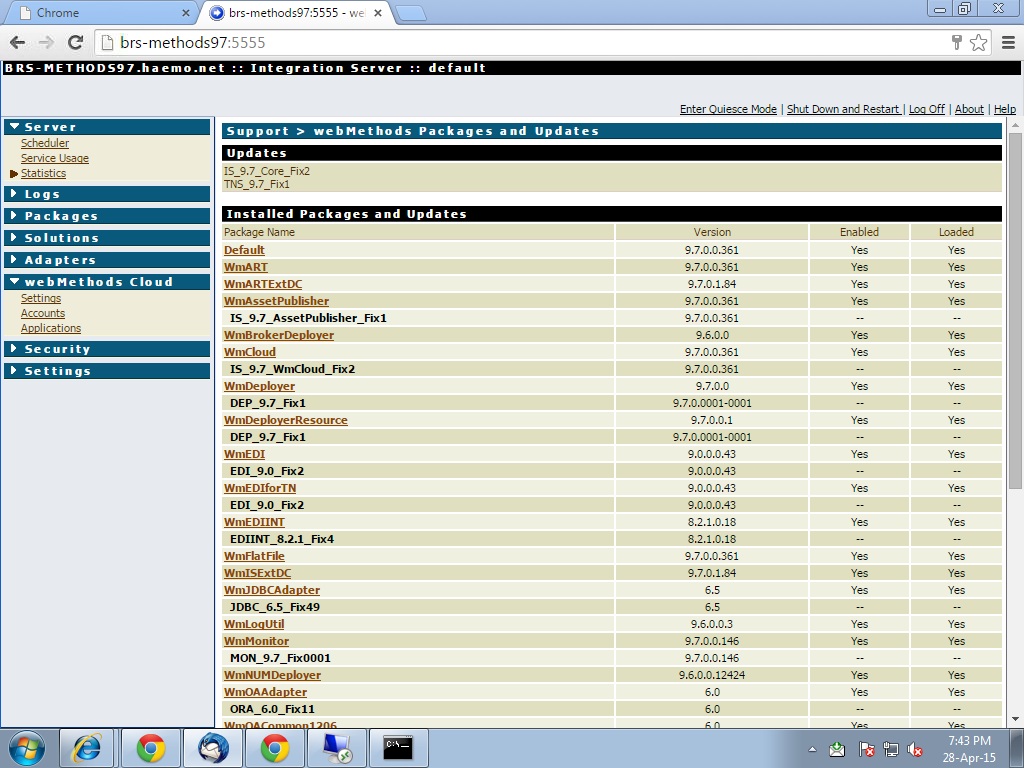

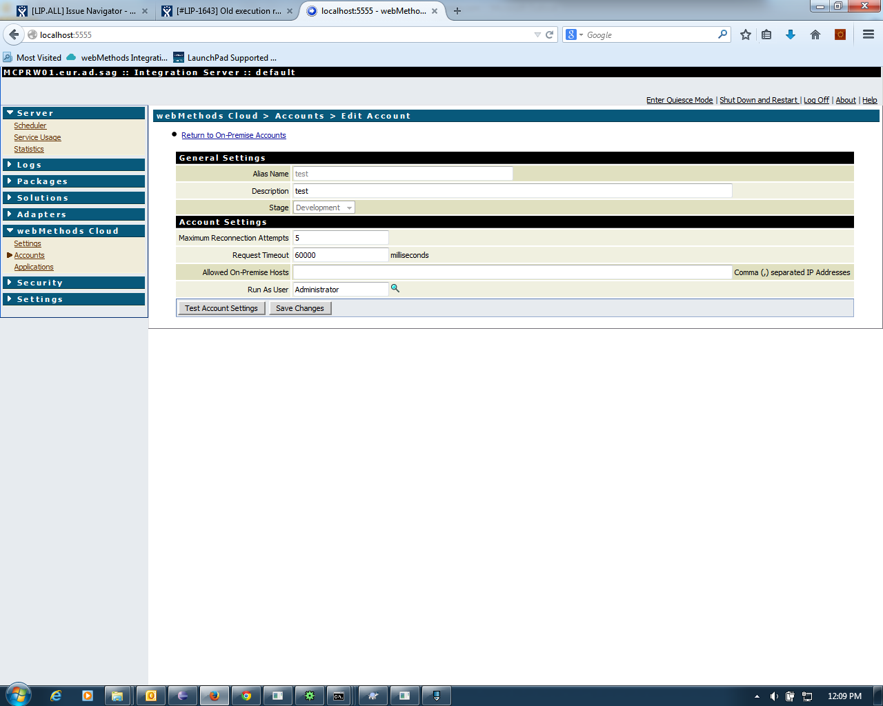

    Please see the screenshots of the applied fixes and the onPremise account creation.
    I have just installed the 9.7 Integration Server, applied latest fixes and was successful in creating a account.
    Can you please check the onPremise account creation screenshot, and let me know if you are doing exactly the same?
    Thanks,
    Pradeep.

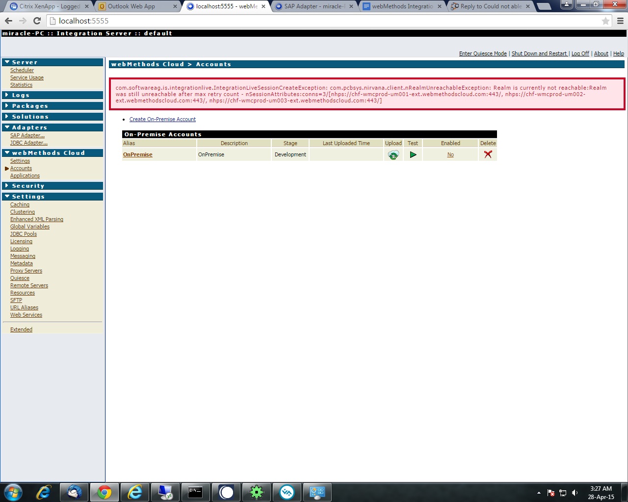

    Posted Tue April 28, 2015 02:57 PM
    I tried enabling the on premise account. But this time I’m getting the following error.
    com.softwareag.is.integrationlive.IntegrationLiveException: com.pcbsys.nirvana.client.nSecurityException: SECURITY: No privilege for attempted operation:1583002654@gandi.sai18@gmail.com@64.208.169.154 Operation : Pop
